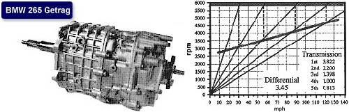

Info from other sites
The G 265 gearboxes always outlive their host cars. Look for them in 6 cyl BMWs: M3 and big six '80 to '82, 528e '82, 535, 635, 745 in '85. They have removable bell housings which is why they are easy to adapt. They might have casting numbers starting 262, but you can tell it is a 265 if it has a 97mm long center casing which is sand cast so it looks a bit duller than the front and back castings. They can take 350 ft/lbs of torque in standard form.
You can get new aluminium bell housings made to fit these gearboxes onto a SBF or SBC for $200 in South Africa. So they must be strong!!!
The ratios of the 265 are well suited to the tiger at: 3.82, 2.20, 1.39, 1.00, 0.81
Less common Opel and some Volvos have a splined output shaft. The BMW boxes have a flanged output so require a propshaft with a sliding section.
(there are two different mounting positions, probably to match different cars.)
Other useful info is that the 265's have either a Ford or a Chevy input clutch spline (Centerforce clutch disk and pressure plate available off the shelf)
265 is a five-speed with overdrive 5th. The 265 is in four sections: tail casting, intermediate casting, main case and bellhousing. To make things tricky, the 265 frequently (if not always) have a 262 number on the main case as that portion is identical to the four-speed 262.
262CR is a "close ratio" five-speed with 1:1 fifth. The 262CR also has four sections as the 265. To distinguish a 262CR from a 265 you look at the intermediate casting. The intermediate casting on the 262CR apparently has a rougher finish than the other castings on the transmission. Also, the bolt holes on the intermediate case are aligned on both ends of the intermediate case so that it appears that you could remove that section and bolt up the tail casting to the main case (that is not the case with the 265).
The M50 & M51 are Volvo getreg boxes
M50 is a 4 speed box
M51 is a closed ratio 5 speed box with a 1 to 1 5 gear
VOLVO The Volvo have a coarse spline on the input sharft and has a normal 4 bolt rear flange and a speedo drive. These boxes come in the 75 to 78 260 series volvos from the factory
The BMW Getrag boxes have a fine spline input sharft and have a giblo drive rear flange
I understand the volvo and BMW boxes have very similar cases but the ratios and the input and the rear flanges and shifters and shifter carrier are different
Volvo m51 (265 with volvo ratios) 1st - 3. 99:1 2nd - 2.58:1 3rd - 1.77:1 4th - 1.27:1 5th - 1.00:1
GpA 240T Homologation ratio's : 1st - 2.328:1, 2nd - 1.675:1, 3rd - 1.353:1, 4th - 1.145:1, 5th - 1.000:1
