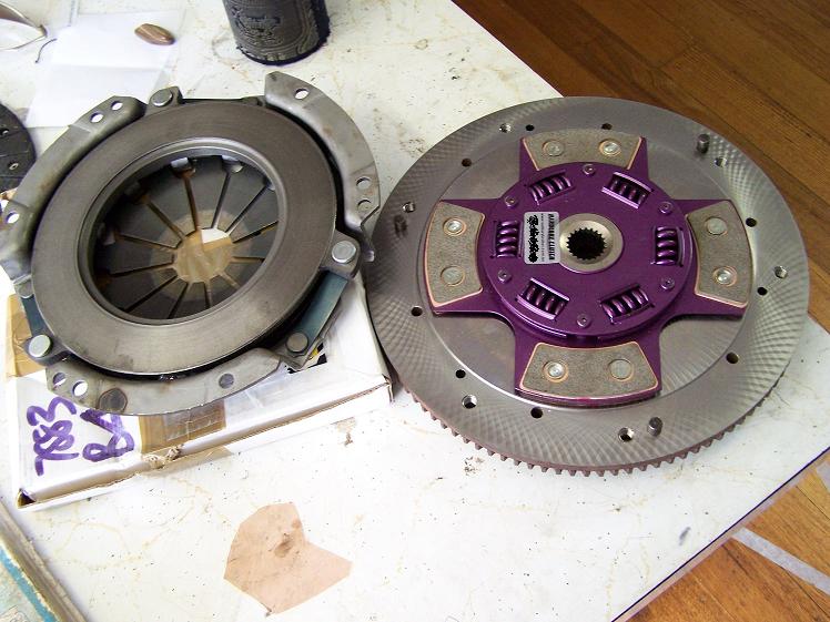

I got the flywheel back from the machine shop and it looked pretty good, so I fitted up a standard 200mm toyota clutch kit (4AGE sprinter), It felt pretty good under the foot and was smooooooth on the road(nice) But as before when it boosted up in 4/5th it started to slip.
I spoke to a number of clutch specialists and decided to upgrade the clutch plate to a 4 puck item i was told this add 30-40 percent less slip.
I pulled the motor and box (getting pretty used to it now), I found that the machine shop had only machined a standard 0.2mm step onto the flywheel as opposed to the 0.5mm I had asked for (They re-machined at no cost).
I fitted it all back up again with the new 4 puck clutch plate, and you guessed it,...... it still slips.
I`m starting to get a bit pissed off about the whole thing, but I won`t let it beat me, I`m now thinking that I will have to get a new h-duty pressure plate but am not sure , I have been quoted $190.00 for a custom, 100 percent clamping force item. I might have to trawl some 4AGE/sprinter forums and see what they have to say. [img width=300]http://datsun1200.com/modules/myalbum/photo.php?lid=21562[/img]

You should have started off with a heavy duty plate on any boosted setup anyway
I personally would have gone with a sprung cushioned ceramic plate myself... but the 4 puck if you can get it off the line and live with the "on/off" way it works will be good too I used to run the puck clutch in my racecar but switched to the ceramic cushioned
Take some more weight off that flywheel too

The gearbox and clutch kit are both toyota items, I have had my datsun flywheel machined and drilled to suit the (200mm) toyota setup.
I bought the standard AE86 kit because it was fairly cheap ($140 on my door), and I thought that at 200mm and about 30 percent more clamping area it should have been up to the task.
Your not wrong about the on/off nature of the puck/button setup, and with a slapper bar setup on the back end can be pretty nasty to reverse park, and take off from the lights (shudder, shudder, shudder, slap,slap,slap).
I`m trying to find a good ultra heavy duty pressure plate, I would have thought that the "haichiruko" squad would have plenty of off the self bits, but I can only find them in kits ($450+), ABS said they could get a (heaviest they make: 100 percent extra clamping load) pressure plate made up, but will take a couple of weeks and about ($220 on my door)this might be my only option.
If I get this new pressure plate I`d like to try the standard clutch plate again and use the puck/button plate as a last resort, My old setup in the wagon had a full face style clutch plate (180mm) and never slipped, so maybe a full face (200mm) unit will be upto the task?
It "only" takes a few hours to pull the motor and box, swap clutch kits and get it back in again, But I`m not as young as I once was, and I really know about it the following week.

Could there be a problem with your thrust bearing not allowing the pressure plate to fully engage?

Well, I think I have it all sorted now. I pulled the motor and box again and fitted a bright pink exeedy brand pressure plate. I was thinking of using the standard clutch plate but in the end I decided to fit the 4-puck item as I wasn`t keen on pulling the motor and box again if the standard clutch plate was slippy. I am quite impressed with the reults, the clutch "feel" is really nice, it is a little heavier than before and doesn`t seem to shudder, it still seems to be of a off/on nature (but not as bad as a lot of people would have you belive) when it is on "hold on to your hats" I had forgotten how fast this little rocket really is with "only" 15 psi boost. I have yet to boost it up in fith gear and i`m not sure if I want to (I have only had my licence back for six months and the old girl didn`t like being locked away in the police impound yard).
I have read various ideas about running/bedding in puck style clutches, some say to "baby" it for 500km or so, others say the the complete oposite and just thrash the hell out of it from day dot?.
