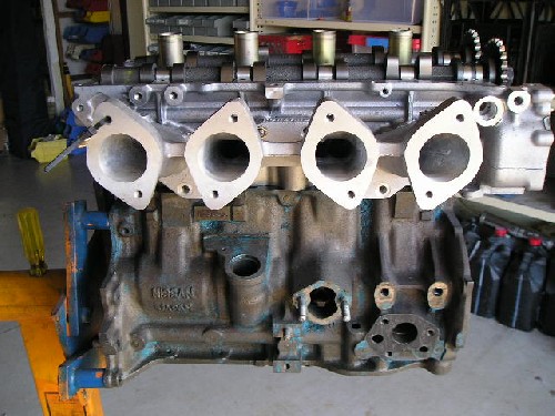

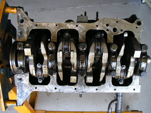

Not meaning to hijack the thread, but all three engines are intersting that is why I have taken parts from all three and are in the middle of building a new race motor.
To give you a little tease it is an A14 block, E16 crank (88mm stroke) with a ga16 head, I have had two billet cams ground up to the same profile as Glenn Seton use to run in his turbo Sierra. I have a BDG 3stage dry sump for it and two 50mm EFI hardware tappered bore throttle bodies, 82mm pistons (1860cc)I have had a lot of porting work done to the head get it to breathe better, I can't put my hands on the flow chart for the head but it is 200hp head.
A couple of members have been aware that I have been building this motor, due to personal reasons I have had to shelve it for the last six month, I now have a fully equipped machine shop under my house so I hope to have it completed in some stage by Christmas.
Enjoy.

Why build manifolds? Just use the stock engine, 115HP, 50% more than an A15 without any mods.
The hybrid above is interesting, but why not just use the entire GA engine?
Posted on: 2010/9/9 7:52
Re: E15/16 vs A15
2002/10/28 6:49
Posts: 10994
due to the racing class requiring the factory A series block.
I think youve missed the point DD that at 1860cc
its the largest A series in the world!!!!
1860cc!!!! and the years spent wondering if an E series crank
will fit is laid to rest!!!
Imagine that 1860cc block with a full works Oval port head!!!!
Gary can you build a 1796cc A15 using flat top ca18de pistons
and offset ground 83mm stroke a15 crank? eg. 83mm x 83mm
A 1.8 litre A would be such a torque monster!!!
