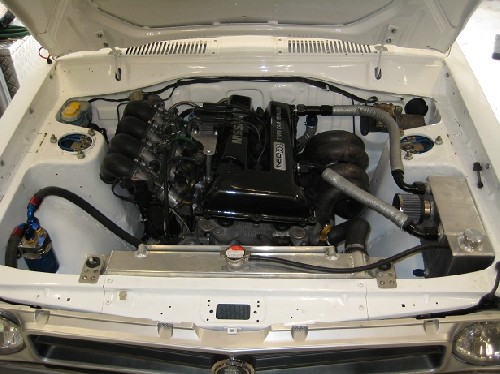

I have had a few people ask me for photos of my new setup..
Any questions shoot them through.. Im more than happy to help.
Hp at the wheels endned up at 179, peak power at 7900.

hell yes. Thats so sweet. I've had a 20VE head sitting on block for the last 3 years waiting for me to finish building the damn car car (1200 sedan) so I can get it in.
What did you uses for ignition trigger?
Also have you used mazworx relocation plates?
What cams/pistons you running?

Nick,
I am running toyota Auto gearbox magnetic pickups, Notched the balancer for one and made a pickup off the front of the exhaust cam with the sensor poking through a small welsh plug hole.
Worked alright... had a few issues with the spacings, would use hall effect (Lip stick) next time.
The Mazworx plate needs around 25ish mm, I had 10 tops. Made my own with only the in and exh cam triggers coming from the solnoids. Ran the purge seperate and remote fed the oil pressure to the solnoids.. seems to be ok.
Cams are factory N1, have a set of Kelfords im going to try soon.
Thanks Hypo14, The sound that comes out of it when the cams switch is HORN!!

If you have any pictures of you relocation plates i'm keen to have a nosey. I'll probably end up making my own too I think.

Hard to get pics Nick, not much room. The mazworx site shows what lines go where.

Looks Horn so I believe you when you say its sounds like it too.
There must be a few horse left in you had better shaped velocity
stacks or some way to get the air from the front just pity about
the right strut tower getting in the way.
