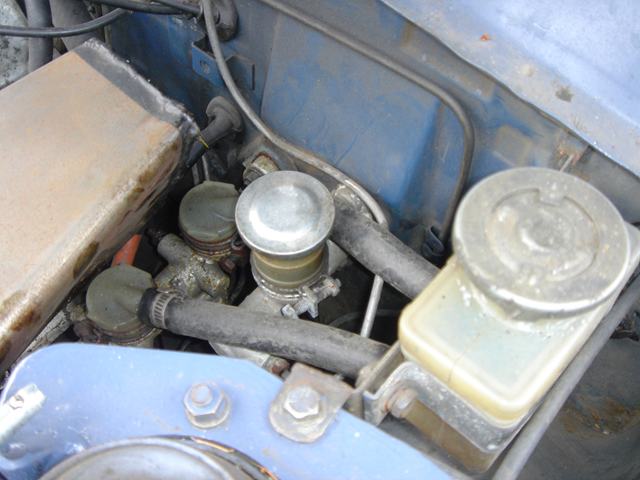

D, I like your idea of a filter box, I'd been thinking of something like that as well, for now though maybe shorter horns will do the job faster & & fab something up later for the box. I think you pic showed a cone type filter on it which seems like that'd allow it to breath well.
David, not sure what you mean byQuote:
You'll want to modify that motor mount
- its the stock cross member & all I did was make the offset mount plate for the right side of the engine compartment as the A15 sits about2" forward of the A12 mount, on that side its only 5/16" higher then stock.
The reservoir itself doesn't seem to have clearance issues rather the MC housing only & as you see in the pic its just the air horn thats banging into it, I think when I get the tranny in it'll all be revealed.
I also checked with the paint mfg & they said they think the paint will hold up fine but my feet will get really hot!
I'll look for shorter air horns Sidedraught, thanks.
