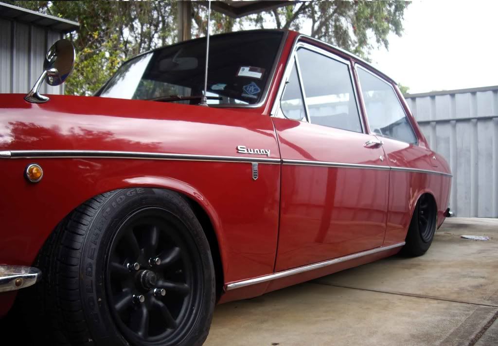

Good advice there and it's true. My car bottoms out because the shocks are very tired,, and when the speed is up it's a wee bit scary when it bottoms out.
Here is how I had mine a while ago, lots more potential to drop it lower.

chris! more lowdown!!!!

couldnt resist it, added some camber for good measure too :)

Looks good! They were too wide to drop it any more, I did drop it another inch and a half after that but they rubbed like all buggery, needed more stretch. Didn't want to flare guards.
