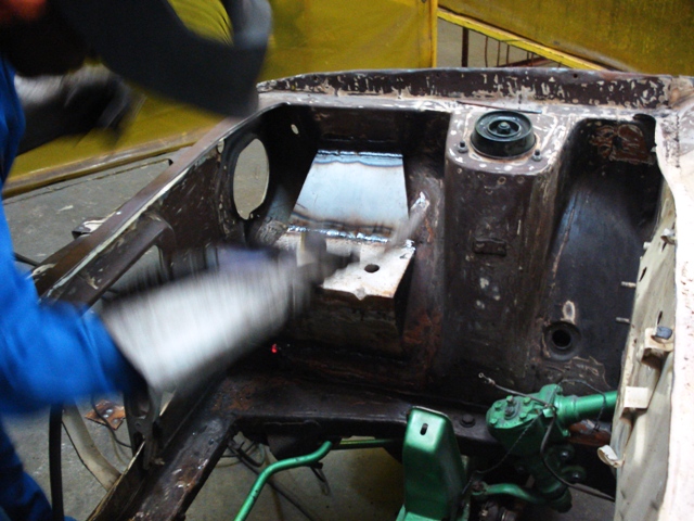

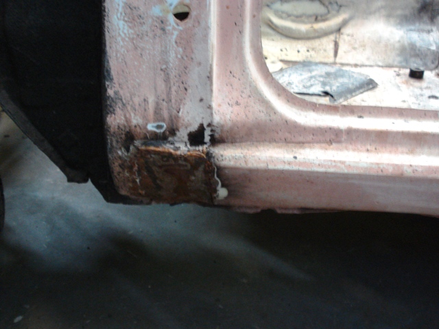

Had some fun fixing the rust so that is luckily done now !!!!!! Here are so pics!!!!!

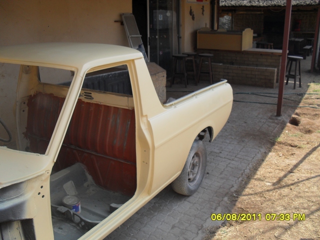

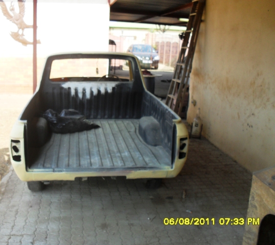

It finally feels like I am getting somewhere after all I have been busy with this build since beginning last year!!!!!!!!! It looks a lot better now with a coat of primer on!!!!! Will get painted this weekend then comes the fun part putting back everything without damaging the new paint job!! Assembling the engine and the rest of the Ute!!!!!!
