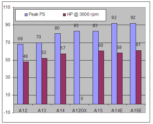

Horsepower of A-series engines
Posts: 31866
stock engine levels - Japan spec
9.0:1 compression ratio
peak HP @ 6000 RPM
peak torque @ 3600 RPM
(except GX, which is 6400 rpm, 4400 peak torque, 10.0:1)
Posted on: 2012/1/20 2:51

0 HP@ 3600 rpm for the A12GX?

A14 GX wins:
http://www.automobile-catalog.com/car ... ellent_sedan_1400_gx.html
Unless this is the L14 like the b110 excellent.
Power gross:
70 kW / 95 PS / 94 hp (SAE) / 6400
Torque gross:
120 Nm / 88 ft-lb / 4000
Posted on: 2012/1/20 21:58
Re: Horsepower of A-series engines
Posts: 31866
That is the L14 GX with twin carbs. A14 "GX" (B210 A14T) is just a standard A14 with twin Hitachi sidies and a better cam. Same head as standard A14.
I like how the standard A14 makes more horsepower @ 3600 rpm than the A10 makes at peak 6000 rpm.
