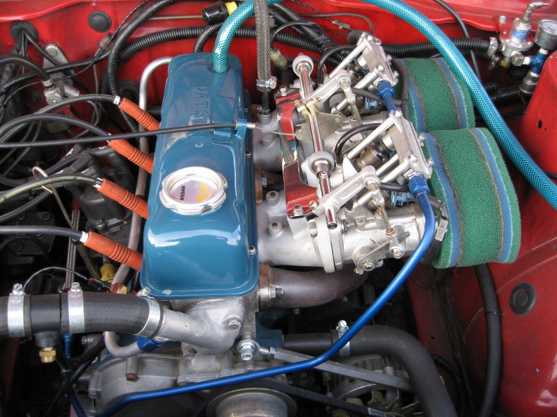

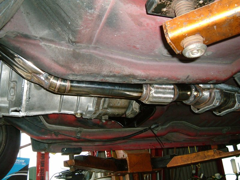

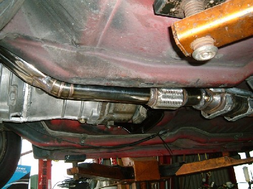

anyway, a couple of pics from owners radical a-series build and abit of info in regards to gearbox...
also very interesting mod list including civic eg6 brake kit.
Try opening link with google chrome web browser as it automatically asks you if you want to translate page into english.otherwise search web tranlator in google.
link:
http://blogs.yahoo.co.jp/sunny3110jpjp/folder/205285.html
"translated" quote
Mission FS5W71C retrofit for R32 Skyline GTS-T late Bell housing production processing Tilton twin plate clutch made ARP flywheel bolts made of reinforced Mosquito wire-type hydraulic clutch clutch → Mission mount production (using R32 Bush) Retrofit for the S110 Silvia H165 Hoshingu Nismo H165LSD 2011-08 changes to the (final 4.875) 4.111
as from pics, cut and shut conversion.

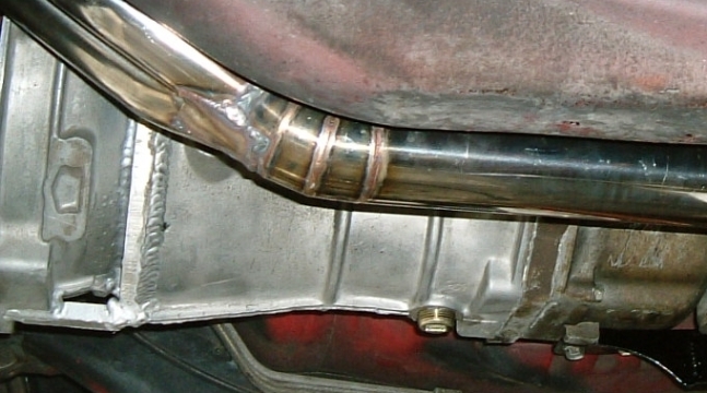

Very nice welding, seems like he used a plate, then 56A bell welded on and some reinforcement posts.
Would be nice to get a complete pic

the welds are really well done as you would expect of japan's workmanship.

those welds on that exhaust and box are awesome ,would the input shaft have to be machined down to fit into the crank or would a different spigot be used instead? any info on the clutch ,was an sr or rb clutch used with a redrilled flywheel?
