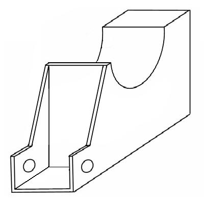

Would something like this be practical?
jpg  sedan_lowering_block_idea.jpg (13.02 KB)
174_509b359a3caa7.jpg 400X400 px
Posted on: 2012/11/8 3:49
