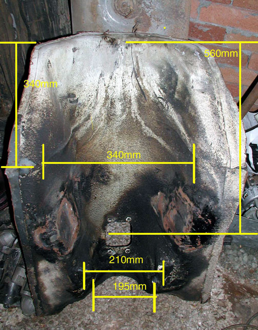

Also, can you get a clutch fork in there by cutting a slot in the auto bell housing?
Posted on: 2012/11/23 13:06
Re: EOI - Toyota T50 adaptor plates group buy cheaper than Dellows
2002/10/28 6:49
Posts: 10983
Enlarge your bottom pic, measre the distances on the area of concern as your manual tunnel has no lips around it making it look smaller. Clearly and obvious as mentioned before the auto is wider in the body and rear where mechanism sits the bell is still in question.
""can you get a clutch fork in there by cutting a slot in the auto bell housing?""
-yes thats right using stock 56a fork
When this adapter plate comes through I will put it in a 1000 and show the clearance required in a manual tunnel.

Good one Mike that means no problems with auto bell as it measures 32cm at the front and smaller at the rear just enough for manual tunnel. Im liking this idea from Dale will have to get the measurements for the face of the T50 box Height x width
Posted on: 2012/11/24 11:56

I hope you realise Dimensioned drawing is an auto tunnel and not my pic, just one I found on here
