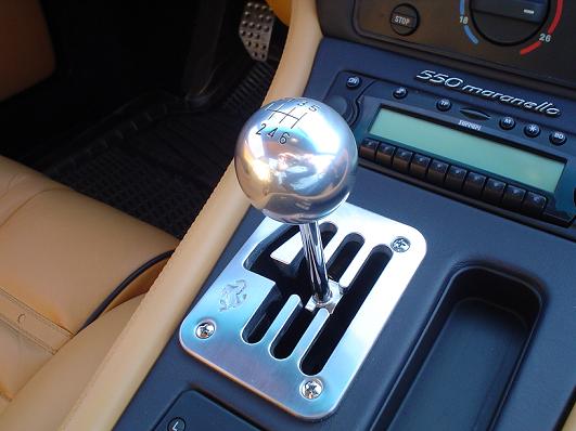

Bugger...... I dont supose anyone has a spare one lying around ? or maybe could take some photos and give me some dimensions so i could get one made... dosent look to complicated from what i can seee from the little picture above....
Alternatively i could make myself something like this below but put a little toggle to stop the lever going to reverse... (ive seen something like that on some race car somewhere....)

The shifter gate won't help. The gearbox needs that part so it won't jam internally.
