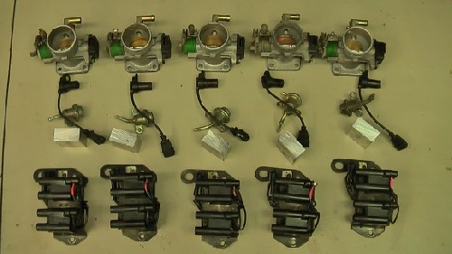

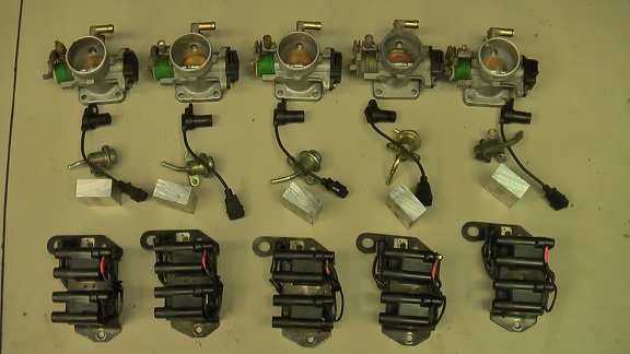

Here is the start of the collection. I still need 2 x A12 inlet manifolds and 3 x standard distributors. If anyone wants a kit, maybe they can supply these parts. The fuel rails will be made from the alloy blocks shown in the pics. They will be a little neater than using a brass "T".
