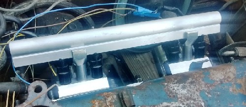

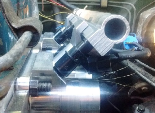

Here are some "renderings" of what I'm working on.
jpg  Mock-up Overview.jpg (180.58 KB)
18181_5739aeb7d581d.jpg 600X722 px
jpg  Fuel Rail Installed.jpg (126.87 KB)
18181_5739aebfbf22a.jpg 800X349 px
jpg  Injector Detail.jpg (170.13 KB)
18181_5739aeca2af1a.jpg 792X575 px

That looks pretty sweet, and similar to the layout on my quad throttle body manifold. I like the look of your brackets for the fuel rail. Do you think you'll make up any more if other people are interested?

Fantastic work! Welding injector bosses onto a custom manifold is a real pain. This is a great solution and done very neatly.
