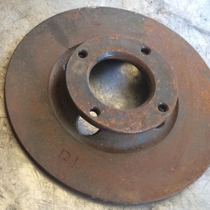

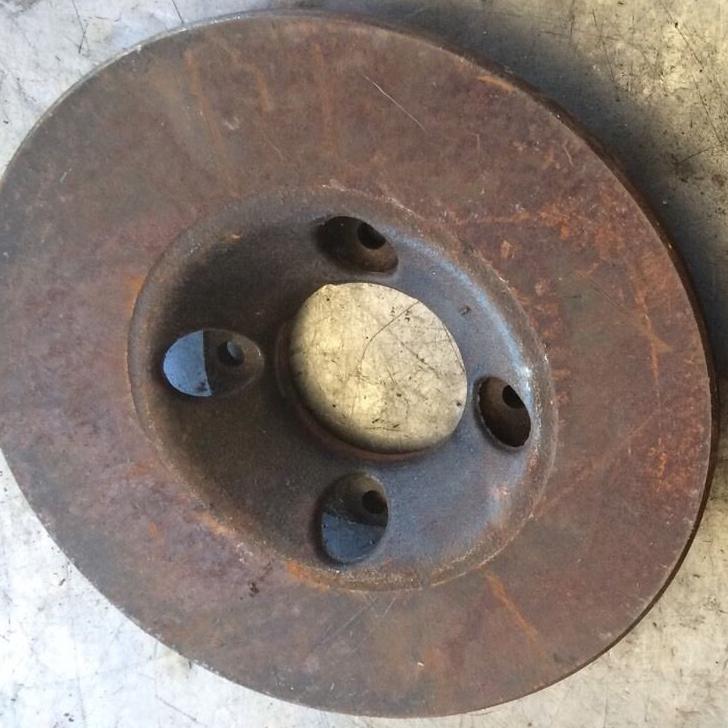

Here's another idea: machine holes in the disc rotor.
Datsun Roadster discs come with holes

@B110SSS as some one who came from bikes to cars; 2 wheels seems to teach you that all important controlled aggression, over do it and the ground will come up and slap you on the side of the helmet. My calculations for the 1200 has every 25lbs = 1 horsepower, granted that's going to vary slightly from car to car. One of our local racers was lost 100lbs and suddenly picked up 2 seconds a lap. At 63KG I'm not going to be shedding anything, of course my son is solidly 10kg lighter than me so maybe I need to start coaching him.
Dave thanks for pointing out the drums are different, it appears I have a set of each, fortunately I have the lighter 240z drums on the car. As for the discs, my car has 280ZX rotors and those have 4 ears that attach them to the hubs. Now it has crossed my mind to mill out the inside of the hubs as well as machine larger veins in the rotor to take weight off (keeping the rotor thickness the same). Of course these things do bring up the Chapman factor of making things so light they fail, nothing like being hard on the brakes, hearing a loud bang as the hub fails and having the car spear off the road.

@ A14force & Dave the ZX calipers are indeed heavy but in order to fit the 13" wheels the backs of them have been milled down so they don't foul the wheel weights and are a couple of pounds lighter than standard but still 3-4 more than the Wilwoods. There is some room to safely shave another pound off the caliper and bracket. At some point I will change these.
The 280ZX rotor can be turned down to shave a pound or two. The Wilwood rotor and corresponding top hat will be 8 lbs so you can get within a pound.
