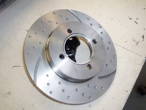

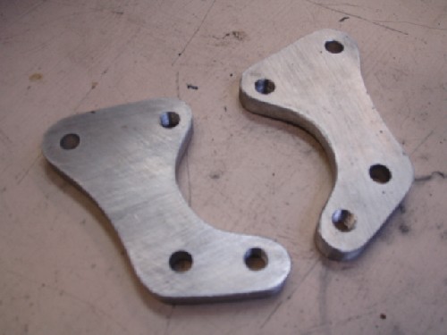

This was done before the paint but its a Quick "how to" fit 245 mm Sunny discs
to a coupe strut
Photo 1) machine up a 9mm hubcentric ring 73mm od 70mm id to press fit into the Sunny discs
2) place the disc on the hub, use a top hap guide to drill tapping m8
3) use the hub as a tapping guide - refit 4 x m8 bolts to secure
4) make a 'dog bone' adapter from 10mm stock steel or aluminium NB caliper bolts are 7/16unf
5) fit dog bone to strut - hub to spindle - caliper to the dogbone
