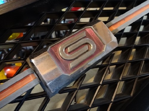

Been busy with work, was able to finally find and get ahold of a square eye Sunny wagon/red grille, so now I will be perfectly happy with staying with the square eye front end. A little pricey but it's saved me from buying the entire front end for a round eye to do the swap so it is money saved overall! In fact I've never seen one of these exact ones for sale before so I'm very excited for it. I also bought another gauge cluster that seems to be in much better shape than the one I had...so I will have an extra just in case a gauge is out or something when I install it eventually. Here's a pic of the grille.

Very nice. The 1981 grille adds the red horizontal line. Basically the 1500/1300 Coupe & GX models

Yeah thanks to your write-ups I was able to decide which was more proper for my 81 wagon; this one or the blue S one without the chrome/red strip. The goodies are starting to stack up. Definitely a few more things I'm waiting to get; looking to create a custom clutch combo using an ORC 309D clutch kit for the a series and swapping in the ORC 309D disk for an L series. They're both 200mm just the splines should be different so I can use the 63a transmission. Not a cheap option but probably the only way to hold up to 300hp with an A series. If I go this route I'll sell off the new Kameari flywheel and Nismo clutch I already have. I am going to want a decent front spoiler and all I can find that I like is the Hakosuka one...not a fan of the style dam Bprojects sells...too chunky for my taste. I also will eventually be on the lookout for proper fender mirrors if I can get the whole setup with the controls for electric control.
