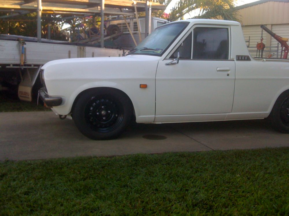

Re: lowering problems, got some pics
2009/2/19 0:51
From hervey bay queensland
Posts: 123
i will take a photo today and post it up, cheers for the info guys.
still gota go another inch at the back but would like to go another 1" in the front and 2" in the back but need shortened struts!!
