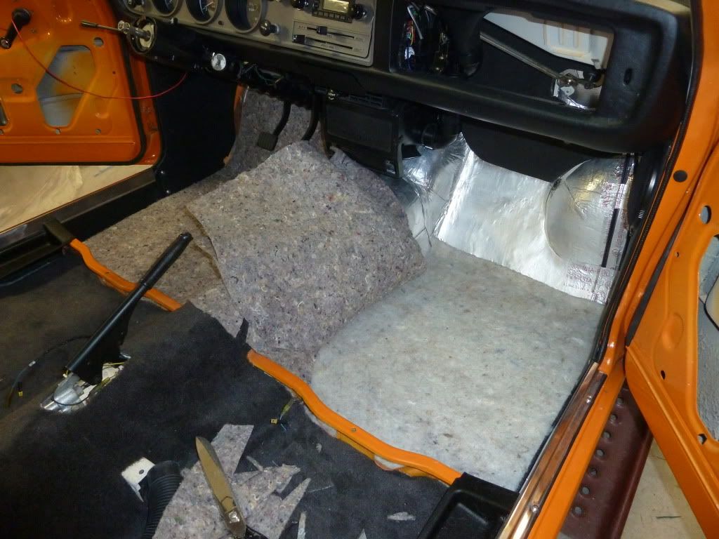

there are other brands that are less expensive on the market & I do think its helpful but still not cheap.
I used: http://www.rumblemat.com/
I think one could buy from a roofing company butel (not asphalt based product!) membrane w/aluminum foil face & use that, I covered mine with 40 oz. jute carpet pad anyways for sound deadening.

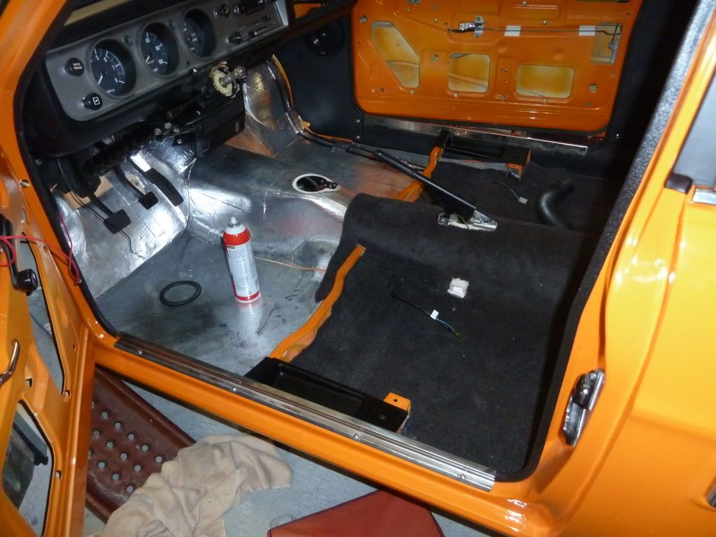

Thanks guys. Roof tar and underlay is a good cheap option.
EDP, foil membrane and 2 layers of that underlay is a great idea and you'd probably hear little noise. Looks nice and padded. Your interior looks fantastic, you just have you peddles on the wrong side! :)
