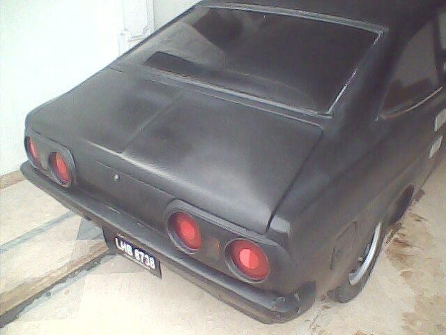

Re: NEED HELP!! A12 Engine |
Joined: 2012/3/20 23:42

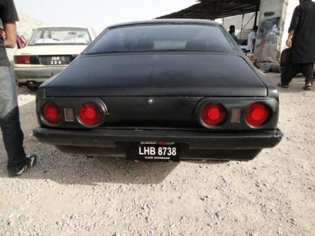

hey mate, as above these should help you out, are they r32 gts-t tailights moulded into the back of it? i have never een that before.

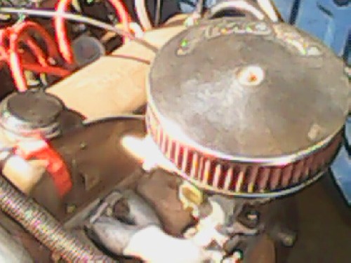

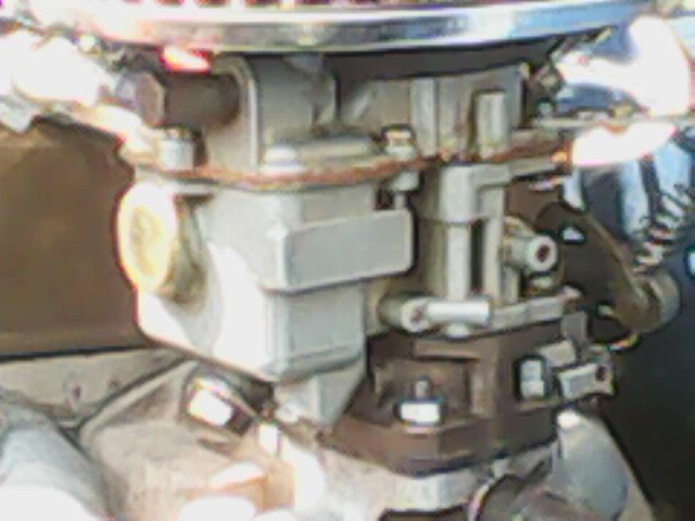

@sikyne, Bro the points are really low quality made in China, dont have a dwell meter, will have have to look into that as that is my only hope, didnt no the timing has to be redone, will do that too.. keep you updated thanks alot brother, can the distributor cause the coil to heat up??, and cant figure out why the engine dies when i floor it... Idles just fine, like too much air or too less petrol... will post a pic of the carburetor please dont mind the bad quality picture, dont have my camera with me have to do with this... @nickmitty.. Thanks Bro... @4slips, Yes Bro, they are R32 Gts-t Tail Lights, they would look better... :)
