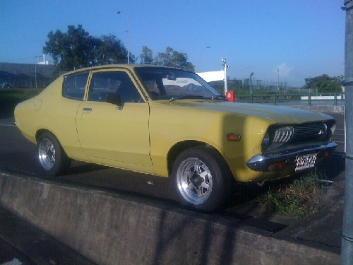

So far I've fixed the only rust it had which was in the spare tyre well, and picked up new rear screen and boot rubbers to try and keep it that way! Found some cheap 185/55x14 semis, and bought a set of wheels to suit - 14x6 +8 and 6.5 +0 Enkie 3 piece wheels. They were pretty light and cheap too - which are the main aims of this build. Whacked some cheap road tyres on them so I can get a RWC to transfer the rego over. Fitted new shifter bushes, gave it a quick tune up so it no longer runs-on, and flushed the radiator. I'm using it as a train station hack at the moment :)

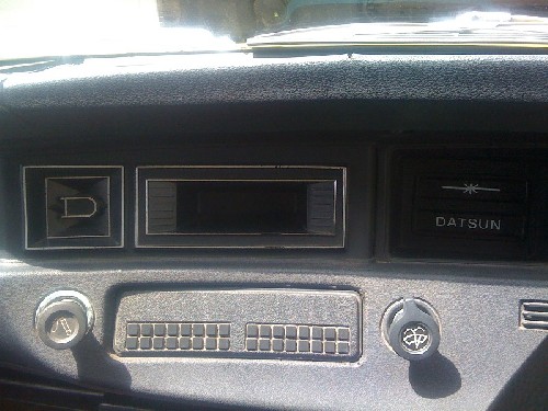

Here's a few pics of it when I bought it, the array of dash blanking plates and at the train station this morning sporting the new wheels - needs some serious lowering!
