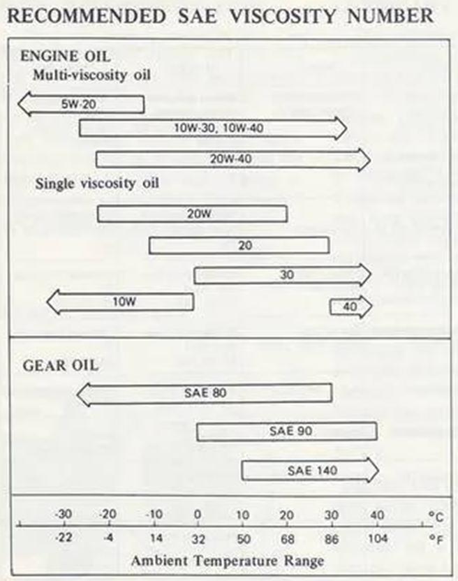

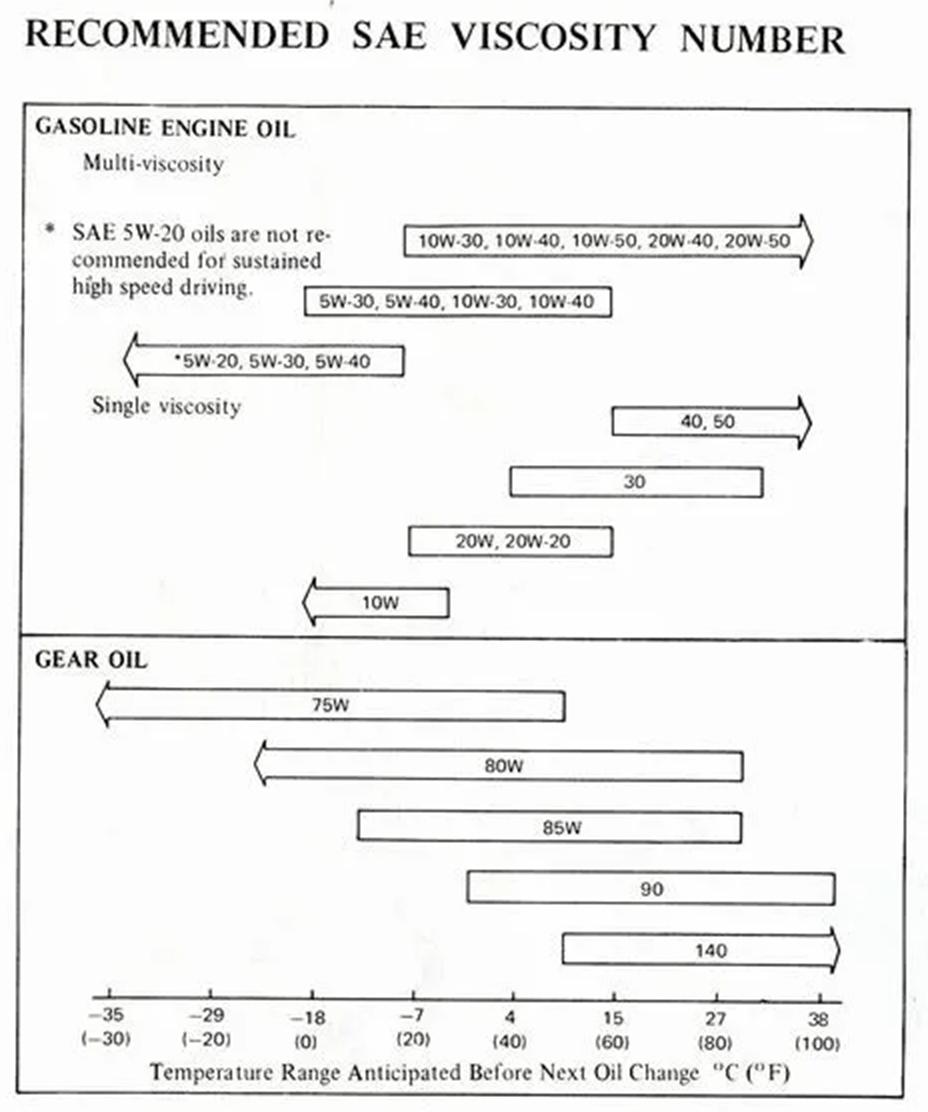

Recommended SAE Viscosity Number
1972 USA Owners manual (Page 24 ... 24):
RECOMMENDED SAE VISCOSITY NUMBER
30454.jpgAlbum 30454
Ambient Temperature Range
1974 B120 Owner's Manual (Page 21 ... 21)
30453.jpgAlbum 30453
Temperature Range Anticipated Before Next Oil Change
