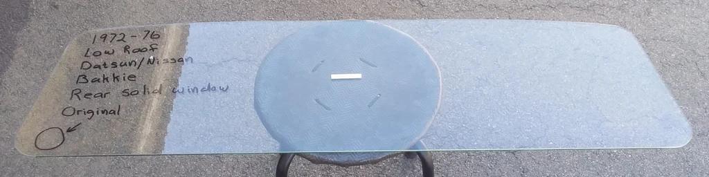

'NISSAN TEMPALEX' on bakkie low-roof rear window
31336.jpgAlbum 31336
