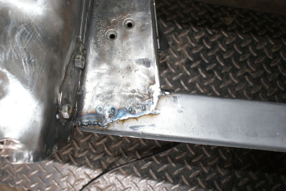

Finally remembered to bring the camera.
Firstly the Beam replacement - got one bent up at ta local steel place for $20 - they made it longer so I could cut it to length. Don't forget that if you do this that the bottom part goes back on an angle, so the easiest way was to put it in place and then bend it according to the existing chassis. I used my handy little spot welder and then the mig for extra strength.
There's still a little paint in the really hard to get at places - in the seams between the firewall and the strut towers and under the battery stand.
I have decided to do the engine bay in 2Pack and the rest of the car in the original Acrylic. I figure the engine bay could do with being a harder surface and gloss off the gun while the rest of the car can be a respray over the original ... thoughts???
anyway here's some pics.....the last one is the look I am going for ... others have titles that match their intent. Enjoy
David.

Nice. I'd rather paint in the corners than what most 1200 have.... rust especially in 1200 where seam between firewall and engine bay.
