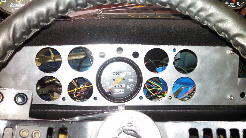

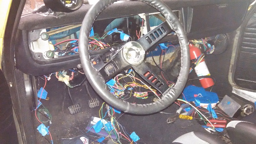

So I made a new panel. One that I can see all the gauges through the steering wheel so now all gauges are on the panel except for my tach which will remain on top of the dash. Still working on wiring. Total Chaos.

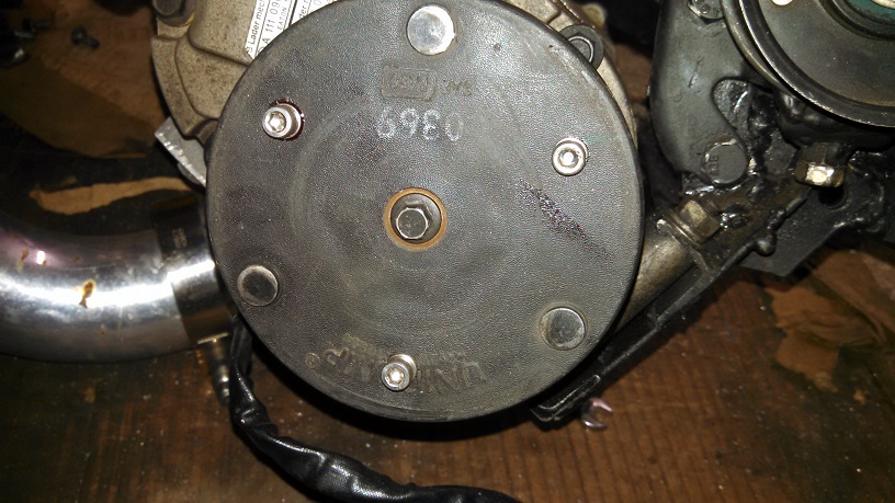

I mounted bolts on the clutch of my supercharger so now its fixed. If it was ever slipping, it wont slip now.
And lastly, I scored on a nitrous fill station. $200 for the tank and pump. I bought it from the guy that is building my adaptor plate for my Powerglide transmission. He's been busy but says hopefully later this week. He's also going to build me a bigger crank pulley for my supercharger. Will go from 6 inches to 7. So at 7000 rpms, that will max out the rated rpms on the supercharger at 14,000. Hopefully my boost will increase to 10 psi.
For now Ill keep plugging away on the wiring. Almost done. Will be nice and neat soon.

Did you put your hands on the wheel to make sure they don't obstruct your view of the guages? I forgot that With my tachometer last time
Posted on: 2014/12/8 21:50
Re: Super Bee KA24DR Mod
2000/1/10 8:43
From Snohomish, WA USA
Posts: 1287
They all look pretty good.
