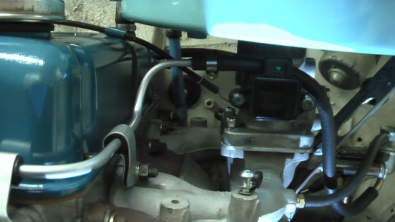

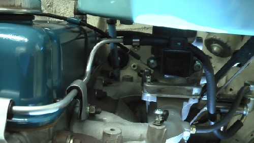

Some pics just to keep things interesting.
The first pic shows the fuel return line using the original carb feed line. The std fuel pump will have to be bypassed. Or remove all these original metal lines and run hose from the FPR straight to the original hard line on the firewall.

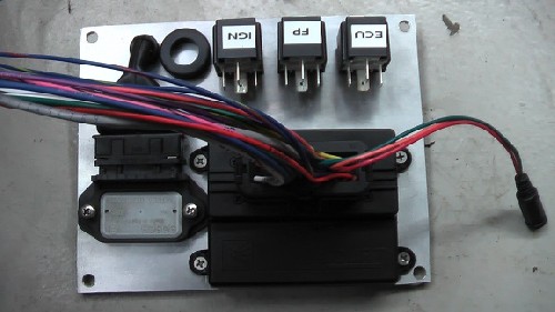

The relays have fuses mounted in the top of them to save mounting extra fuses. Just saves a bit of wiring. The fuses are not fitted in the pic.

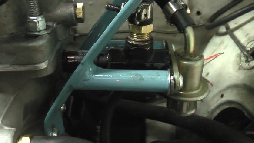

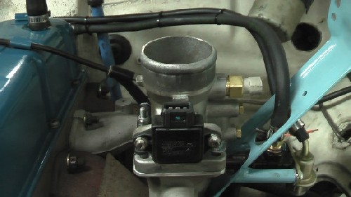

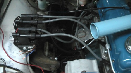

I ended up removing the standard steel fuel line around the front of the valve cover. Both the feed and return lines now follow each other behind the engine. Just flipped the FPR up the other way so the line points toward the rear. looks a touch neater.
The injector finally arrived!

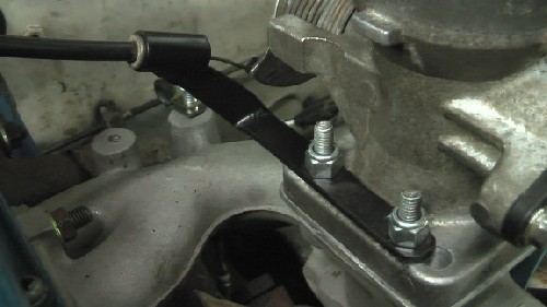

Had to make a cable bracket.

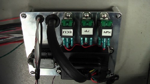

Also an updated pic on the ECU panel. Still need to wire up the module when the right one arrives.

Been playing with this project again. Finished off the wiring today. I hope I don't have to make any changes cos I've covered it all with heat shrink.
With a bit of luck, I'll have it running and tuned tomorrow!?!
