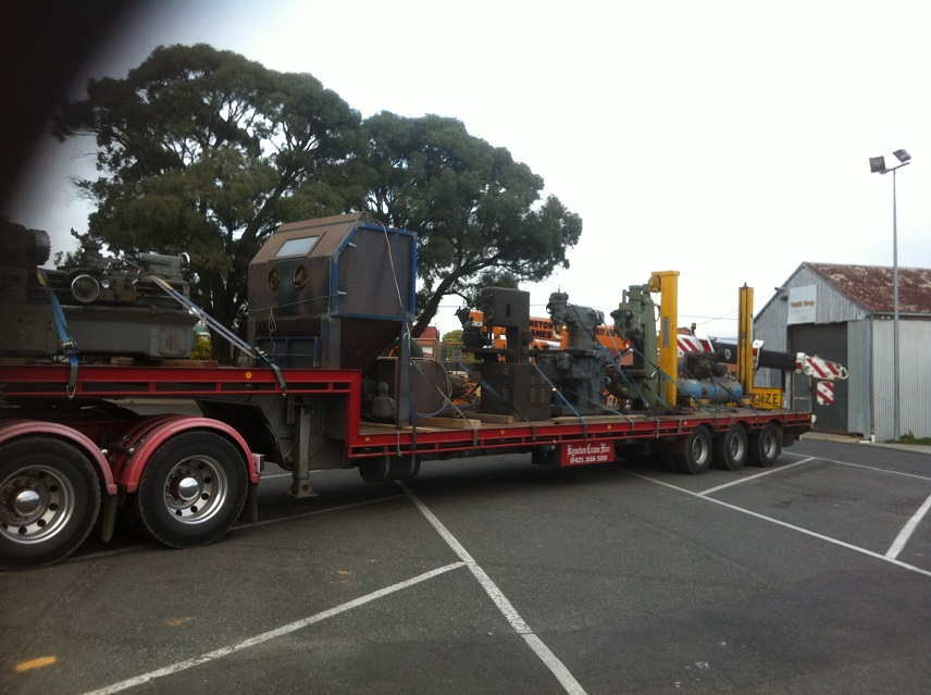

The move has started!

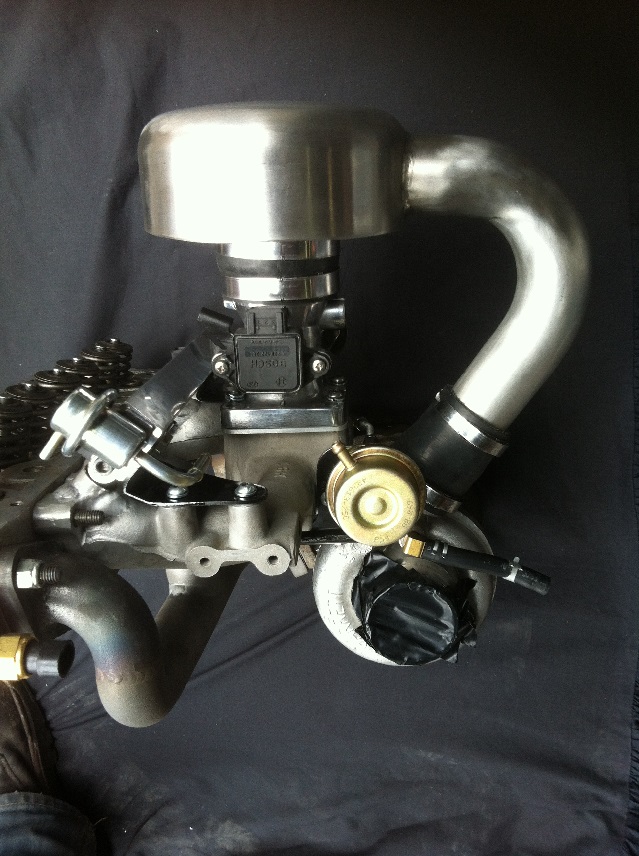

Here is a pic of an A15 turbo setup using the Hyundai TB and Microsquirt. I put 4 injectors on this one.

Re: Turbo EFI A12 for under $1200. Discussion thread
Wow new old toys Simon. No more driving to get to your machines.
Where did you place the injectors?

yeah, it'll be great to have the machines at home. Things should happen a bit quicker now.
The injectors are aimed into the ports. That long block of ally in the pic is the fuel rail. I still used an OEM FPR. The way the compressor outlet lined up with the TB, there wasn't enough room for the single injector and FPR to be mounted in the PCV hole.

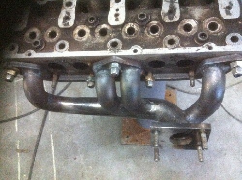

Turbo manifold pic before it was blasted.
2002/10/28 6:49
Posts: 10991
good looking setup all in silver chrome etc
any idea on the turbo exhaust manifold alone?
