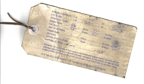

This is one of Clives
Might be abit big for a stock bottom end on the street though
jpg  cam card.jpg (50.25 KB)
527_56ebd34d767b1.jpg 800X471 px
