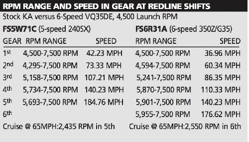

What is the FS6R31A 6 spd weight ?? As it clearly has the advantage over the 5 spd
jpg  Screenshot_847.jpg (101.82 KB)
14887_5aac6f142e06c.jpg 771X440 px
