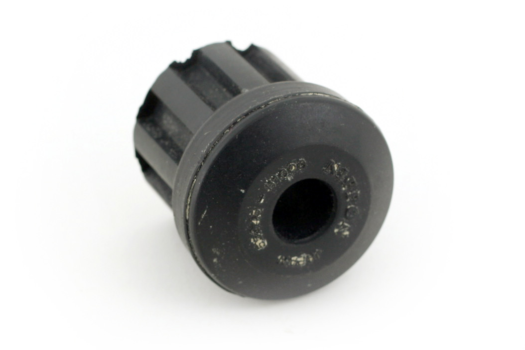

Bushings
18316.jpgAlbum 18316
5 55044-H1001 front upper Sedan, Coupe
  * superseded by 55044-H5001 $4.90 USD
  24085.jpgAlbum 24085
6 55045-H1000 front lower Sedan, Coupe [leaf eye, course] $3.63 USD
17 55046-H1000 rear upper $2.27 USD
24927.jpgAlbum 24927
18 55047-H1000 rear lower [leaf eye, plain] $1.22 USD
NOTE: B210 USA uses the same bushes as 1200 Coupe/Sedan.
