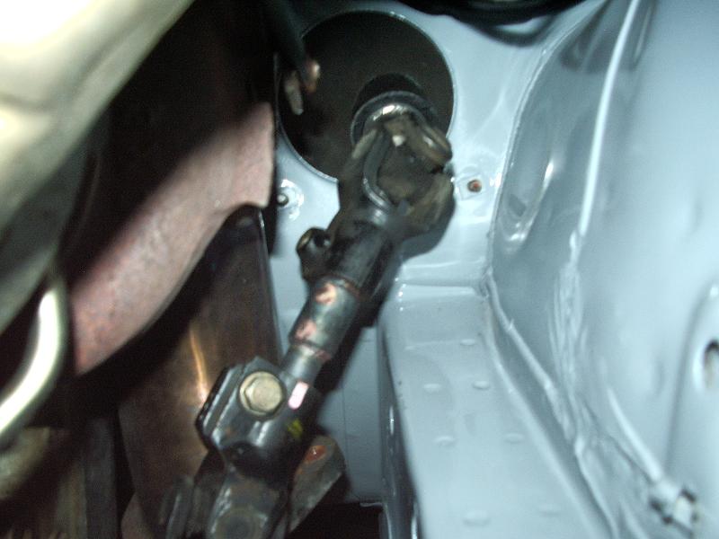

Had the steering link shortened today and installed, the rack works nice and smooth. Installed the turbo and exhaust mainfold. Heat sheild is on too.

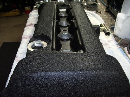

Like the rocker cover mod, in your opinion, whats best way to do it. I reckon it makes the motor look like a lotus twin cam

I tried getting acouple of different machine shops to do it, but they all said no. so I just used a grinder and a sander. still got some more fine sanding to do then it's off to powdercoat. and Thanx for the compliment.

thanks silvia-specr ,what are the main advantages to rack and pinion and could i run it without power steering ?
did you need to shoren the rack ? and can you please explain how you are putting the 240sx front end in ? what mods ? and what components are you using

i am running mine with no power. mostly just trial and error, right now i will most likely end up with some bumpsteer. will work out the kinks in the system later. Thanx, here is a way i found after i had done mine. after i cut off the treaded tudes for the lines i just inserted grease fittings and filled with grease. here's a link http://www.nicoclub.com/archives/howtoo-steeringrack.htmlhope this helps

Been working on more of the front suspension, got the arms cleaned up and painted, also cleaned up the valve cover the rest of the way. and got it painted. A couple of pics also with the new center plug cover.

Attention to details I see! Looks great!
