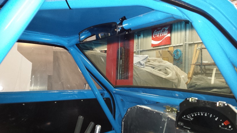

The convex interior mirror works very well and
gives a great view out the rear. It makes up for
the crap door mirrors.

jpg  inside mirror .jpg (132.76 KB)
10466_57209f67c124b.jpg 820X461 px
