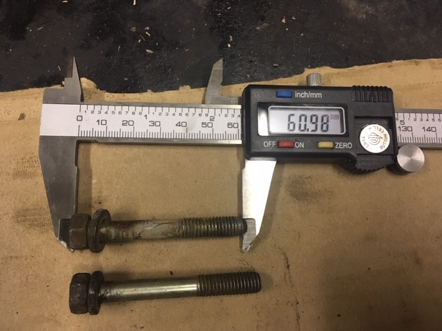

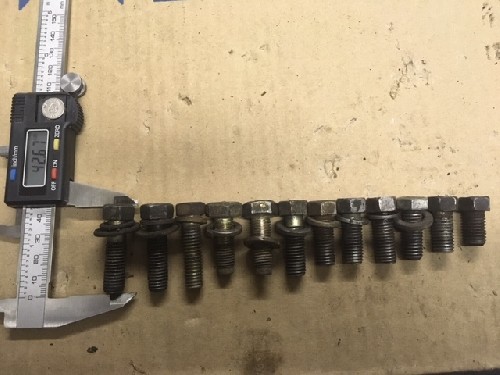

Need help sorting through the bag of bolts I have to get the correct bolts to secure A series engine to transmission. I have 2 different long bolt lengths. Also does the starter have 2 different size bolt heads? If I could get the Tech Wiki link that shows all of these bolts that would be much appreciated.

Bolts to fasten the starter to the transmission -- two identical bolts
08121-03533 (2)
08 NES
12 Hexagon bolt, Medium carbon steel
10 M10
35 35mm length
or with the optional Reduction Gear starter
08121-03533 (1) [35mm length]
08121-04533 (1) [45mm length]
By the way, it's not in the wiki because the 1200 catalogs are missing it (both JDM and USA). The other catalogs B210 and B310 have it as above (those are where the 60-series comes from anyways it is the same bolts whether 56 or 60 series)

Re: 60A bell housing bolts
Posts: 31750
56-series & 60-series & 63-series. Wiki has B110 parts at Transmission Case Part Numbers (see #1, #9 and #24)
transmission case to engine block
* Late: 08120-85510 BOLT-hex early (6)
* Early: 08120-86010 BOLT (6 + 1 for gusset upper bolt)
So it was either a set of six 55mm bolts or six 60mm bolts
whether engine uses the 3.5mm plate or not doesn't matter, uses same size bolts (some early models had the plate, and some late model did not)

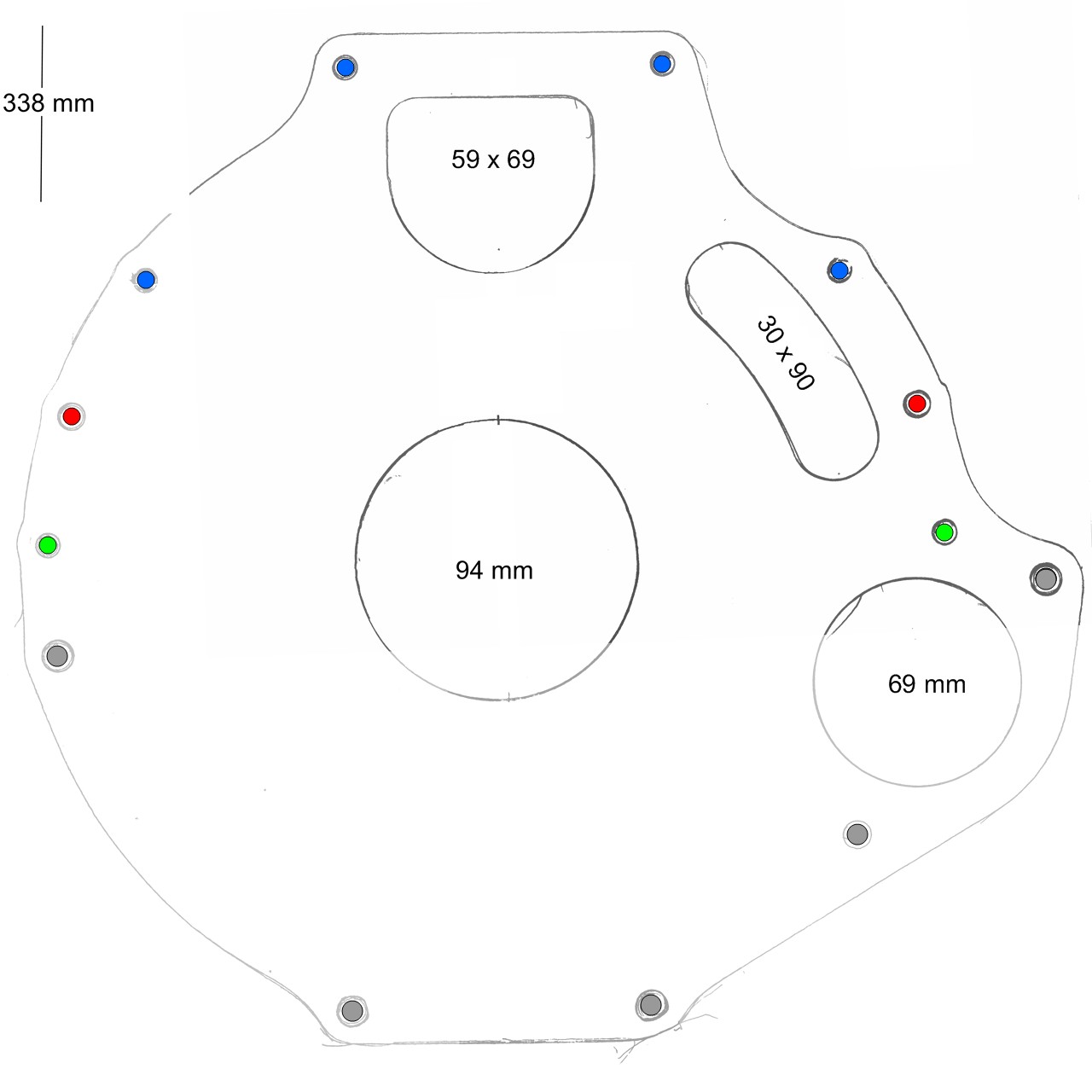

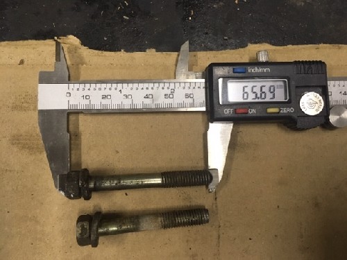

Thanks DD. Need more help on this. I found an old thread that you had on this same subject and you made a nice sketch. Are there any markings on the bolt heads that would help me sort them out? With regard to the long bolts, I have more of the 65mm than I do of the 60mm which appear to be the correct ones? I wouldn't think there would be a problem to use the 65mm. I have 3 setups, 2 are A15/60A 5-speed and 1- A12/56 4-speed all of which use the 3.5mm plate. I am sorting the bolts for the A15/5 speed.
Can't seem to find the correct starter bolts. There are a pair of identical bolts in one of the pics about 35mm but are not the proper thread for the starter. Any way you can tell if the bolts I have posted belong with the housing?
Older thread............
HOLES
Blue: 8.5 mm
Red (dowels): 9.5 mm
Green: 8.5 mm
Gray: 11 mm (bottom two are 10x11 oval)
BOLTS
Blue & green (6)
* 08120-06065 4-speed, 08120-06010 5-speed
** hex bolt medium-strength, M08(?) x 60mm long (6)
Gray Starter
* 08121-03533 BOLT-HEX W/WASHER(M10 X 1.5) (2)
** medium-strength M10 x 35mm long (2)
Gray bottom right
* 08111-02062 BOLT-HEX HEAD WITH WASHER, COVER TO TRA
** M10 x 20mm low-strength
Gray GUSSET Engine-to-gearbox
* left side, bottom two holes (fits in from front)
** 08131-04010 56-series high-strength M10 x 40mm
** 08131-03010 60-series high-strength M10 x 30mm

Per the catalog they should be either 55 or 60 mm long. Measure doesn't include the head
55 and 60 are not mixed on one transmission. At first Datsun used six 55mm, later changed to six 60mm. They are marked blue and green in the diagram. The others are the two starter bolts and the optional dust cover/motor plate bolts

Starter bolts are:
Nissan Part Number 08121-03533 BOLT-HEX W/WASHER(M10 X 1.5) (quantity 2)
* medium-strength carbon bolt M10 x 35mm long
* I don't know what the head size is (my faltering memory is telling me 15mm?)
you can get bolts like this at Ace hardware or NAPA or just about anywhere. Even at the Nissan dealer but they are the most expensive

Makes sense! Ok will remeasure tomorrow. Any way to visually tell the difference between low, medium and high strength bolts? All of the bolt heads have a number or letter stamped. Does that indicate anything. Thanks again.

That's a good question
Metric bolt in general are marked on the head
* no marks (equivalent to non-metric Grade 2 or 3)
* 8.8 (equivalent to non-metric Grade 5)
* 10.8 (equivalent to non-metric Grade 8)
* 12.9 super strong
But I don't think the old ones have those marks
Nissan bolts sometimes have an alloy formula mark
* T (strong)
* 12 (stronger)
* 13 (chromoly V steel much strong)
In your photo it seems
a. '4' unknown meaning, like the bolts that hold the air cleaner on
b. 3 radial lines (American Grade 5?) This video has that triangle mark
c. Maybe the bottom two bolts if i remember correctly
wiki: Fastener ID markings
