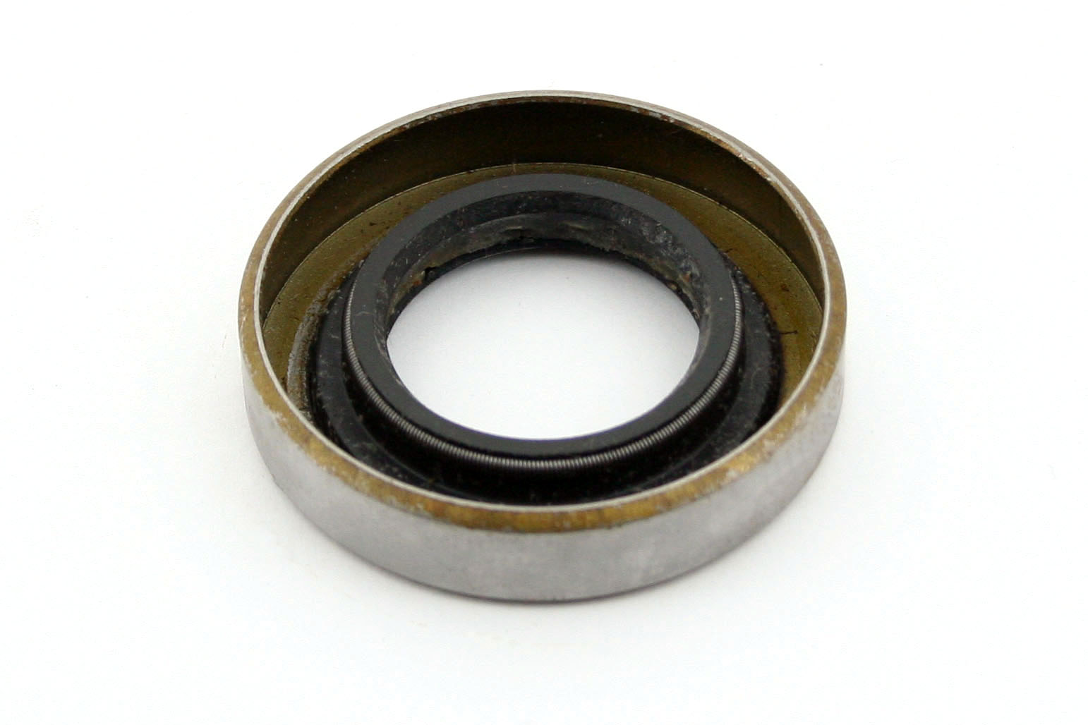

Pinion Seal
B110, through 1974 model year B210 (H145). Probably fits B10 as well.
38189-18000 SEAL-OIL DRIVE PINION
SKF Oil Seal #550219 $22.99

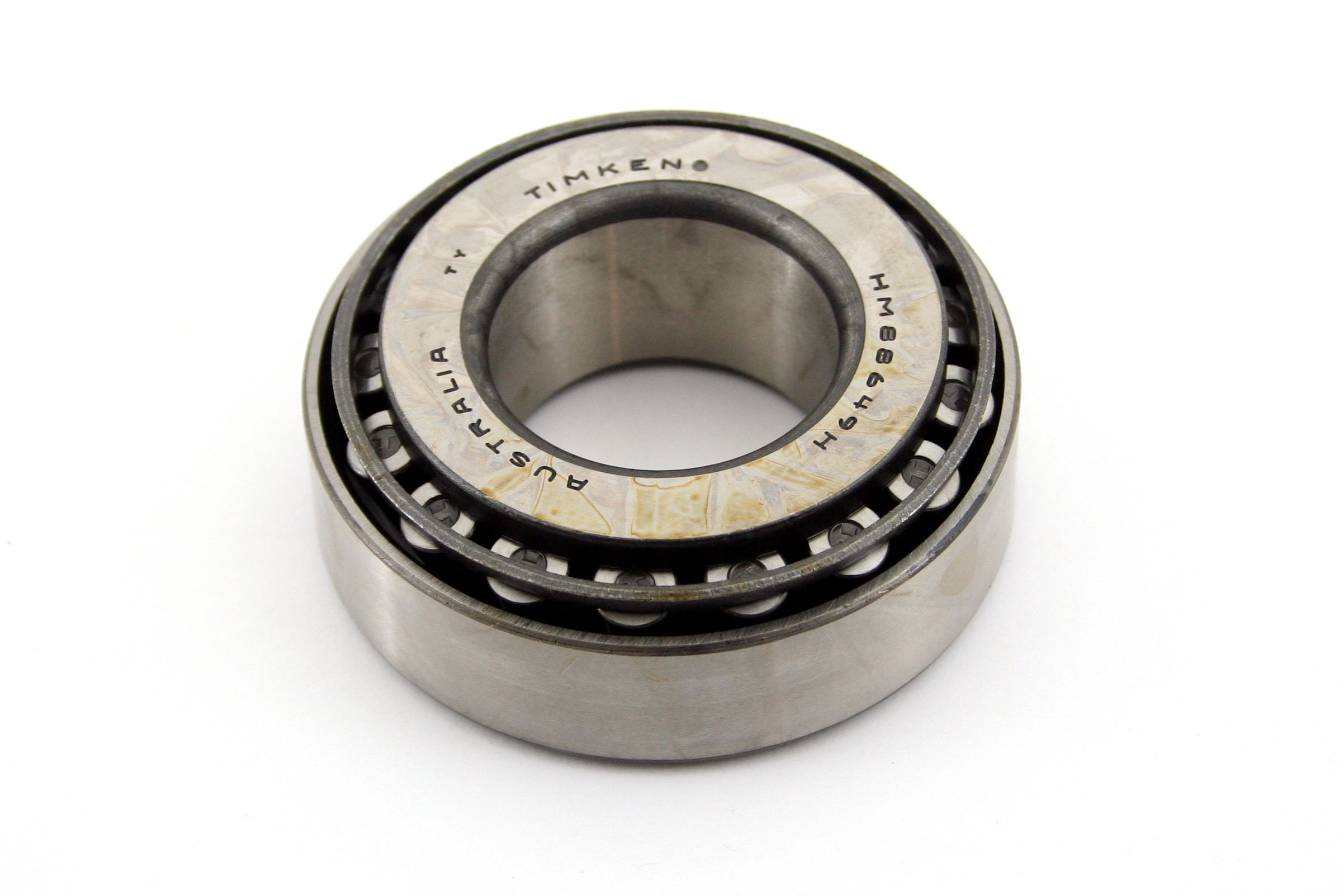

Front
38140-18000 ASSY-BEARING DRIVE PINION FRONT
* Koyo 303/22X
* NSK HR303/22CNF
NSK HR303/22CNF specifications
Radial Taper Roller Bearing
* I. D. 22 mm (0.866")
* O. D. 56 mm (2.205")
* Width 17 mm (0.669")
Timken HM88649H

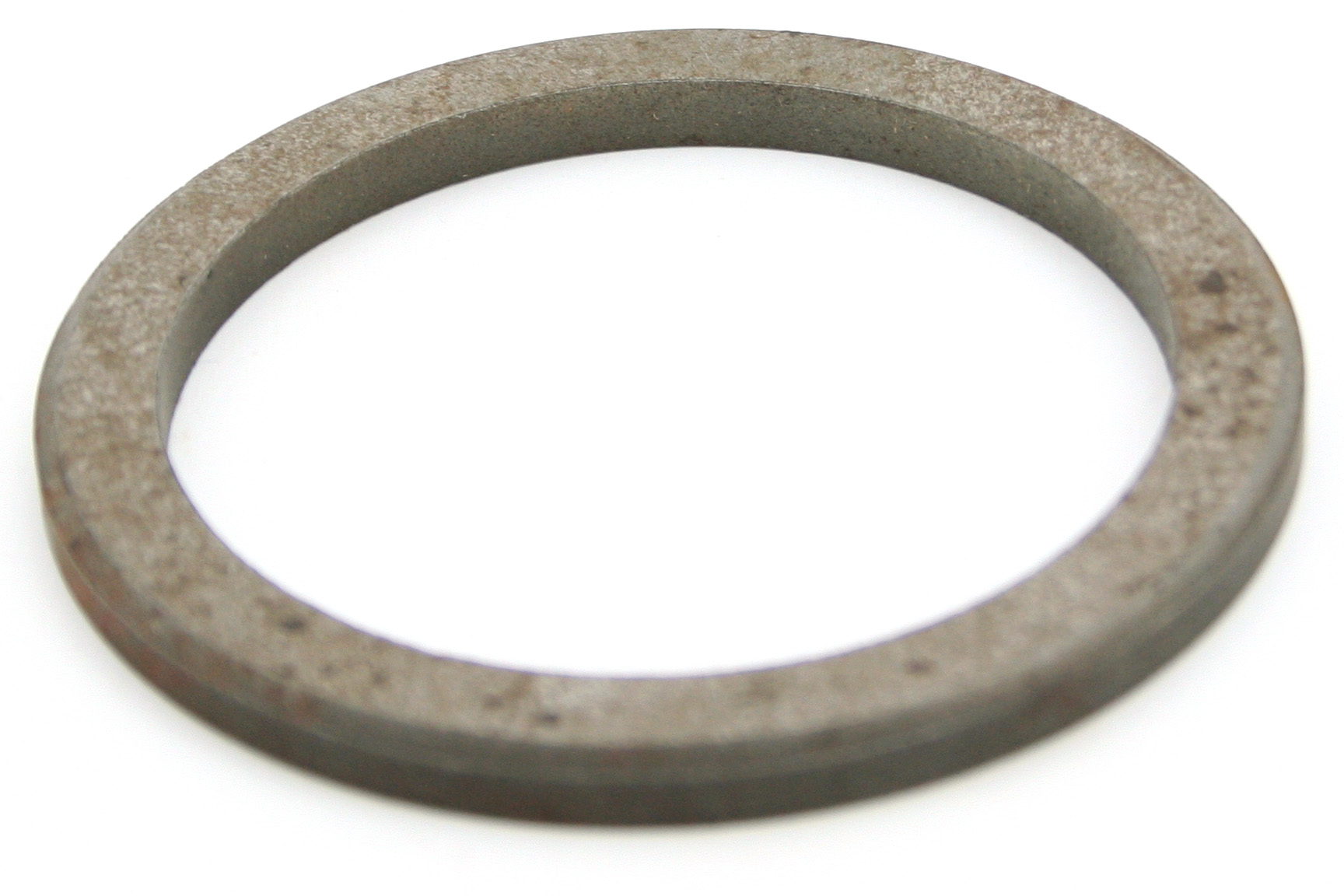

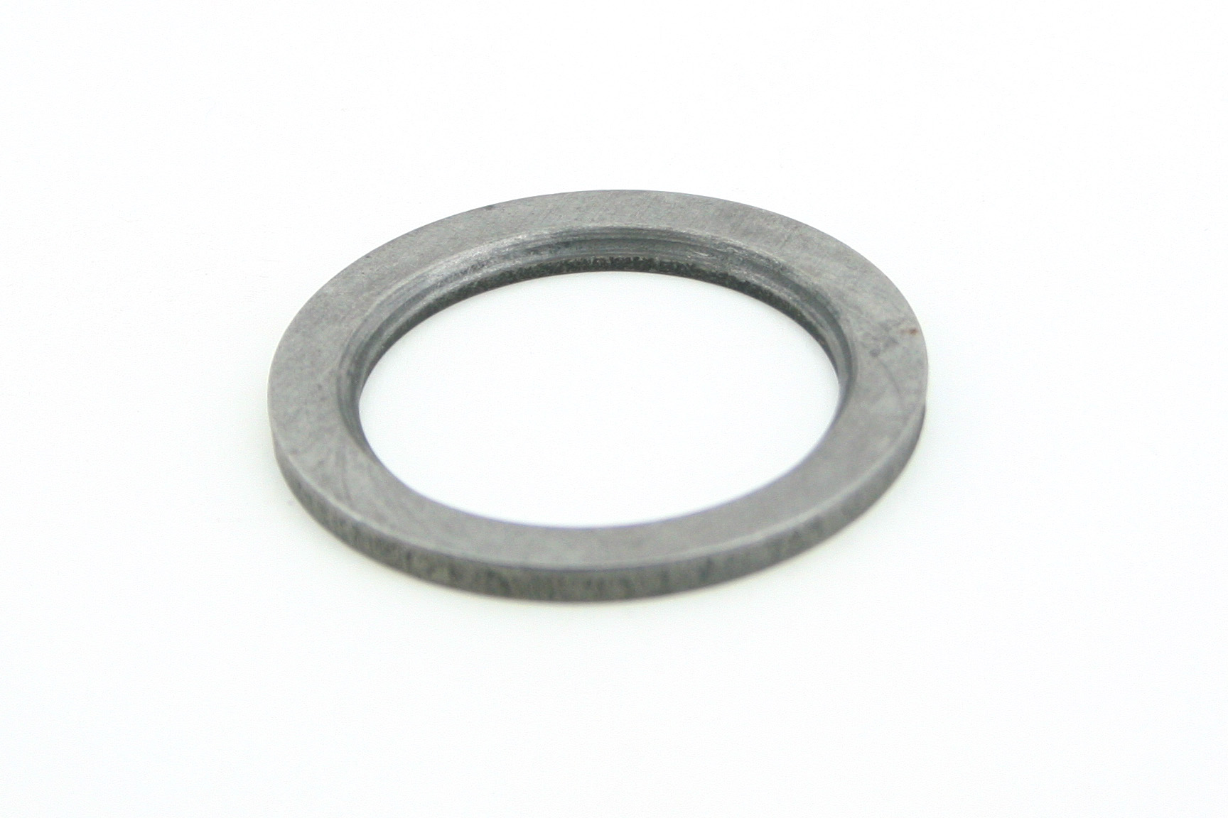

Shims
Also need these:
* 38165-H1001 SPACER-DRIVE PINION BEARING $17.00
* 38154-G04xx WASHER-ADJUSTING DRIVE PINION $3.83 USD
Where xx = 00 through 17 for different thicknesses
* 38154-G0400 WASHER-ADJUSTING DRIVE PINION T=2.74
* 38154-G0401 WASHER-ADJUSTING DRIVE PINION T=2.77
* 38154-G0402 WASHER-ADJUSTING DRIVE PINION T=2.80
* 38154-G0403 WASHER-ADJUSTING DRIVE PINION T=2.83
* 38154-G0404 WASHER-ADJUSTING DRIVE PINION T=2.86
* 38154-G0405 WASHER-ADJUSTING DRIVE PINION T=2.89
* 38154-G0406 WASHER-ADJUSTING DRIVE PINION T=2.92
* 38154-G0407 WASHER-ADJUSTING DRIVE PINION T=2.95
* 38154-G0408 WASHER-ADJUSTING DRIVE PINION T=2.98
* 38154-G0409 WASHER-ADJUSTING DRIVE PINION T=3.01
* 38154-G0410 WASHER-ADJUSTING DRIVE PINION T=3.04
* 38154-G0411 WASHER-ADJUSTING DRIVE PINION T=3.07
* 38154-G0412 WASHER-ADJUSTING DRIVE PINION T=3.10
* 38154-G0413 WASHER-ADJUSTING DRIVE PINION T=3.13
* 38154-G0414 WASHER-ADJUSTING DRIVE PINION T=3.16
* 38154-G0415 WASHER-ADJUSTING DRIVE PINION T=3.19
* 38154-G0416 WASHER-ADJUSTING DRIVE PINION T=3.22
* 38154-G0417 WASHER-ADJUSTING DRIVE PINION T=3.25
38154-G0410 | 38154-G0403
Diff%20Adjusting%20Drive%20Pinion%20Shim%20(38154-G0410).jpg Diff%20Adjusting%20Drive%20Pinion%20Shim%20(38154-G0403).jpg
