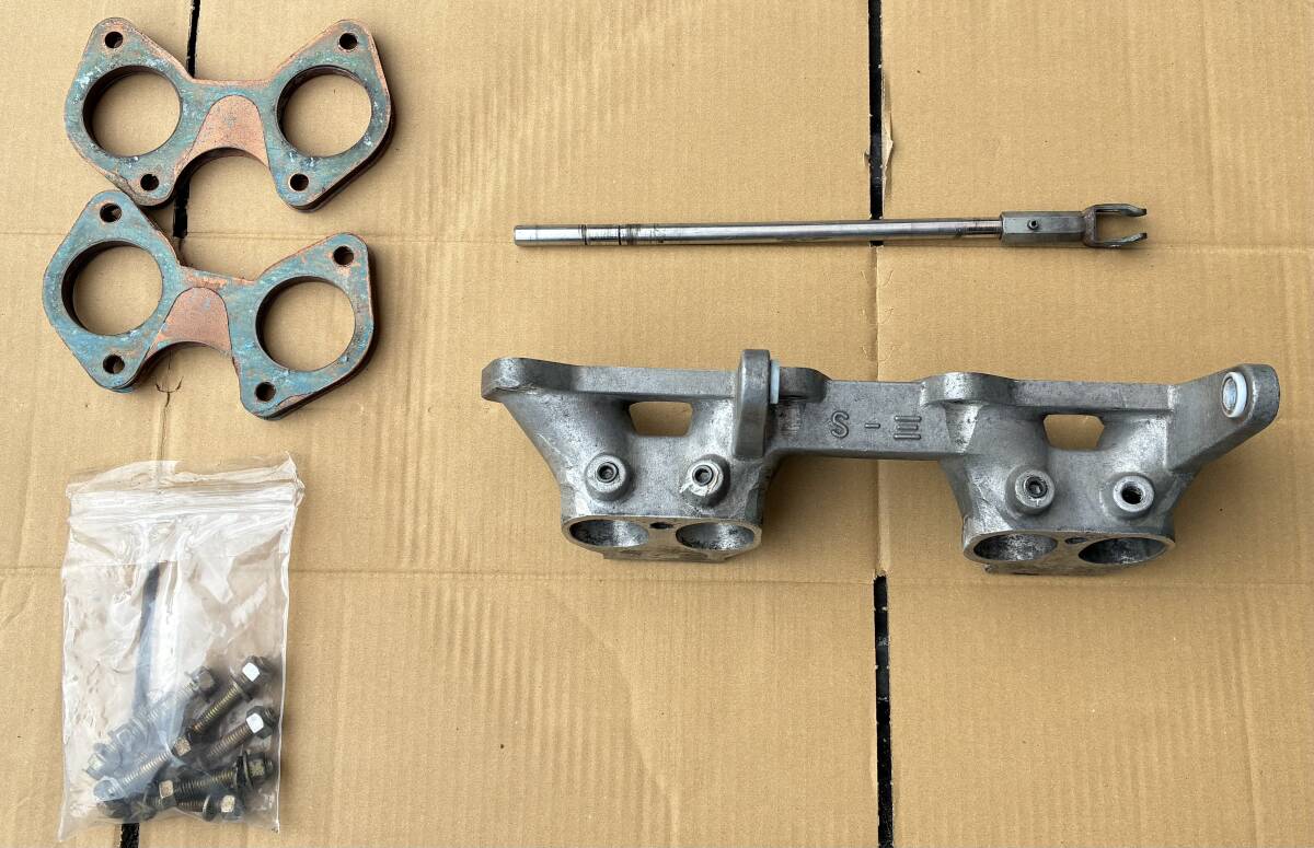

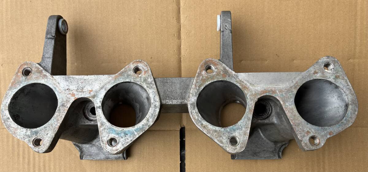

S-3
S-三 or 三-S (S-3) manifold is very short, with the linkage towers right at the head flange.
31261.jpgAlbum 31261
It has original early-A12-style port bolt-pattern but it looks like it has GX-size ports.
