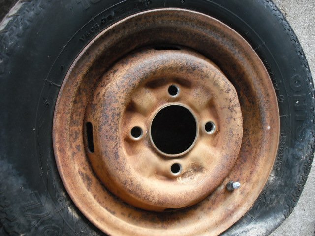

Stock 1972 Japan wheel. Notes the metal tabs to hold a dog-dish hubcap
14999.jpgAlbum 14999

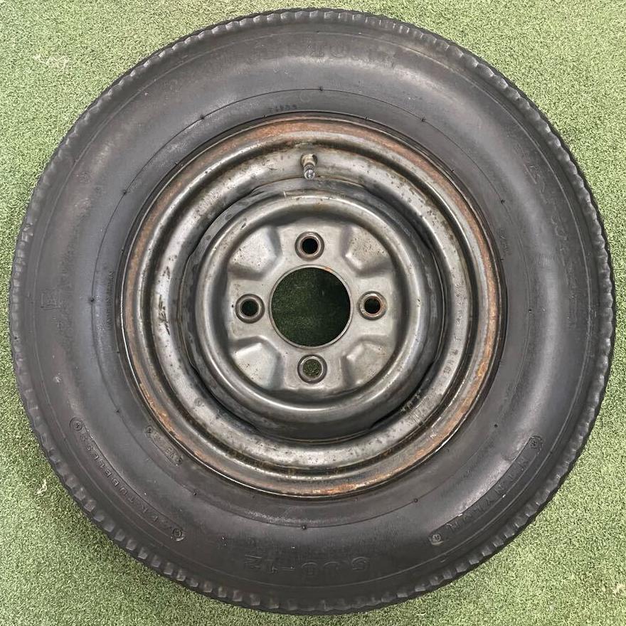

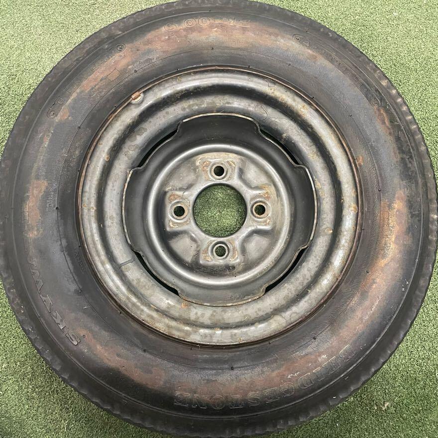

Notes the lack of tabs, but with four nubs to hold a dog-dish cap. Raised ring area around the lug holes
h45019349t9630801-img411x405-116122.jpg 09.jpg 174_59eda22f6f5b7.jpgPost 486530

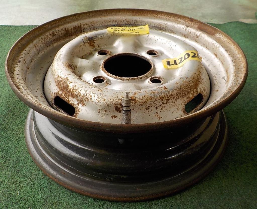

B210 12" wheel? Slotted, with conical wheel hat. Stamped '59 23D 13 T NISSAN 4JX12' with 73mm hole and +30 offset, no dimples
30619.jpgAlbum 30619 30620.jpgAlbum 30620 30621.jpgAlbum 30621

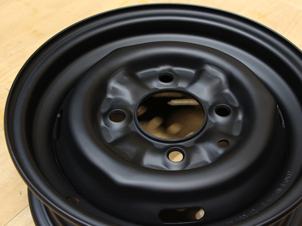

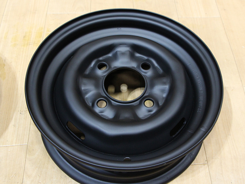

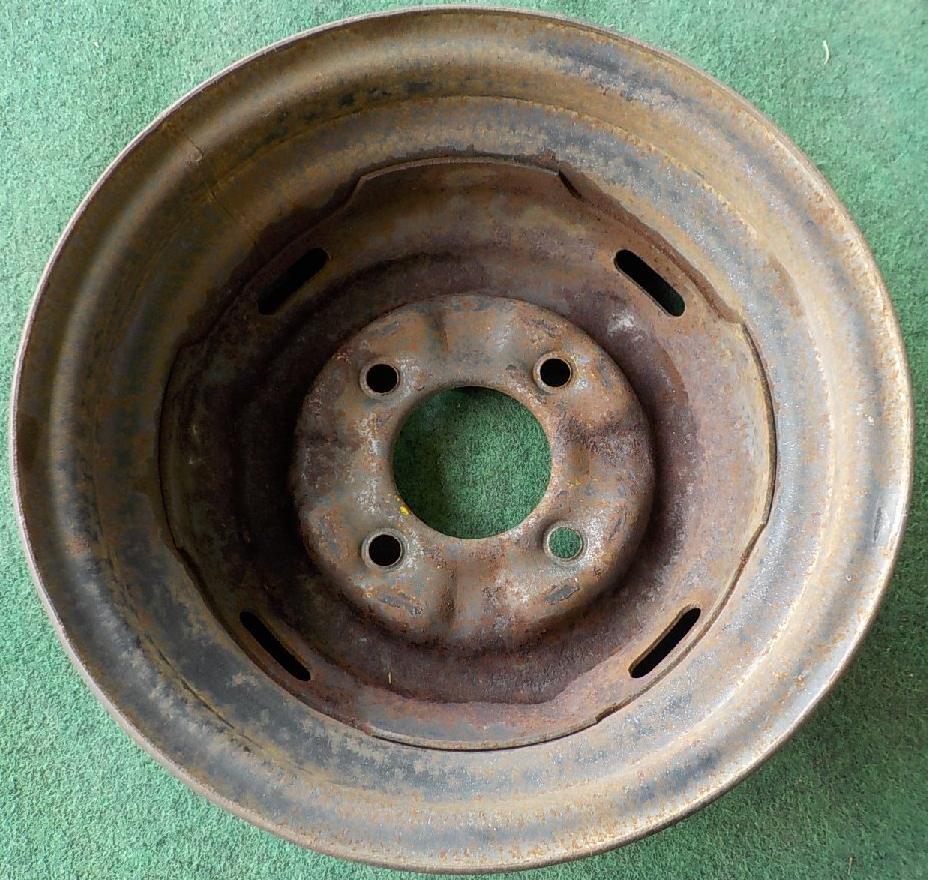

B310 Wheels

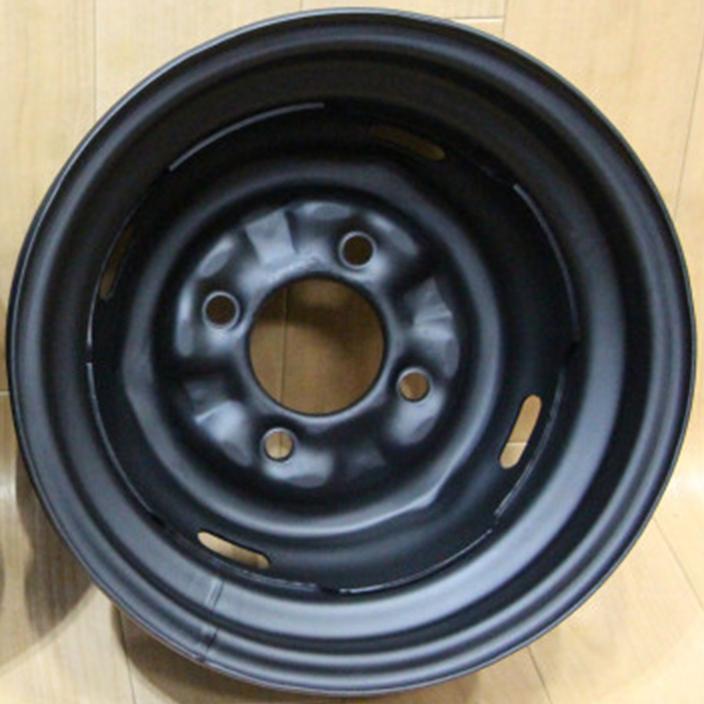

B310 12-inch
B310 A12-powered 12-inch wheels are similar spec to B110: 4Jx12+30
30611.jpgAlbum 30611 30615.jpgAlbum 30615
  • almost vertical wheel hat with four slots
  • 3 cap nubbins
  • Stamped 'NISSAN 4JX12'
  • 73mm center hole (hub bore)
  • Ring area around lug holes
  • Dimples in the raised portion between the lug holes

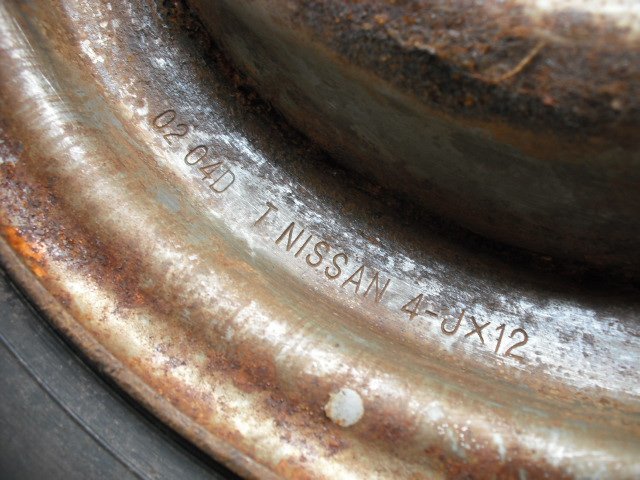

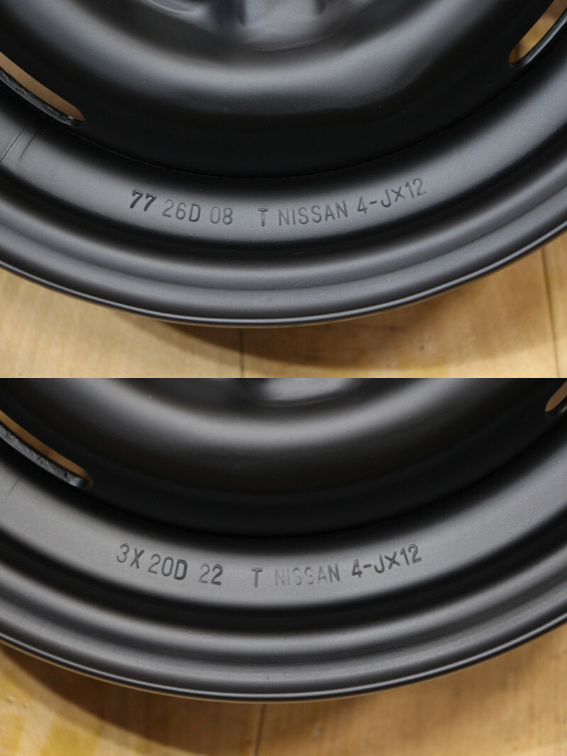

Stamped 'T NISSAN 4JX12' proceed by production codes like '77 26D 08', '3X 20D 22' and '02 04D'
30616.jpgAlbum 30616 30617.jpgAlbum 30617
