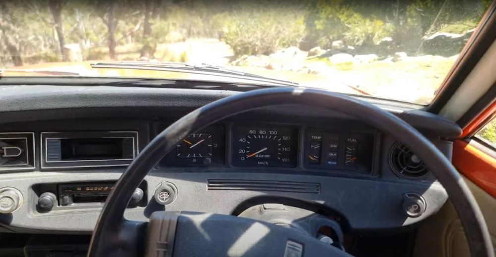

Most B210 models used a square-gauge dash, which were considered "modern" at the time.

Lesser B210s used rectangular gauges (kaku meters, literally angle meters)
174_65cfafb7e3ab8.pngPost 498290
like these GL sedans:
174_59bdcaa67aab5.jpgPost 486111 28422.jpgbrochure
