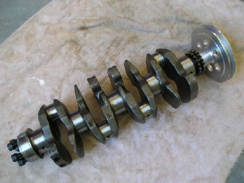

Here is a couple of photo's of the E16 crank I have modified for the A-series block.
There is a couple of ways to make it work, either way is going to cost you money.
One way is to use the E16 crank with a Nissan conrod and get custom pistons made, or the other is to use the E16 crank with a aftermarket conrod and a shelf item piston, either way it will cost you about $800 - $1000, Pistons or Rods.
I have gone for the custom piston option.
On top of this there is of course the mods needed to the crank to get it to fit, (I'm lucky I can do all of this myself at home, would hate to think what it would cost to pay someone to do it all.)
Once again, two options, modify the rear of the crank to make it similar to an A-series crank, or modify the A-series block to suit the rear of an E-series crank. I have done the first option on this crank, it's alot of work to do it right!
Next time for my biggest block I will mod the block, why - I like the thought of the bigger PCD of the E-series bolts for the flywheel, going this way means of course I will need to make a custom flywheel to suit.
When I find time I am working on the 88mm stroke and 79mm (custom JE pistons) motor - 1725cc.
The three motors I'm working on at the moment are,
big - A15 crank 78.5mm pistons 1587cc
BIGGER - 88mm crank 79mm pistons 1725cc
BIGGEST - 88mm crank 82mm pistons 1860cc
Edit - One of the hardest things to do with these cranks is to actually find one, they are virtualy non-existant in Aus.
I have three, one I was extremely lucky to find in Aus, one I got sent over from a fellow member in N.Z. the third I got from America which cost a fortune. If you have one of these in Aus. consider yourself very lucky.
