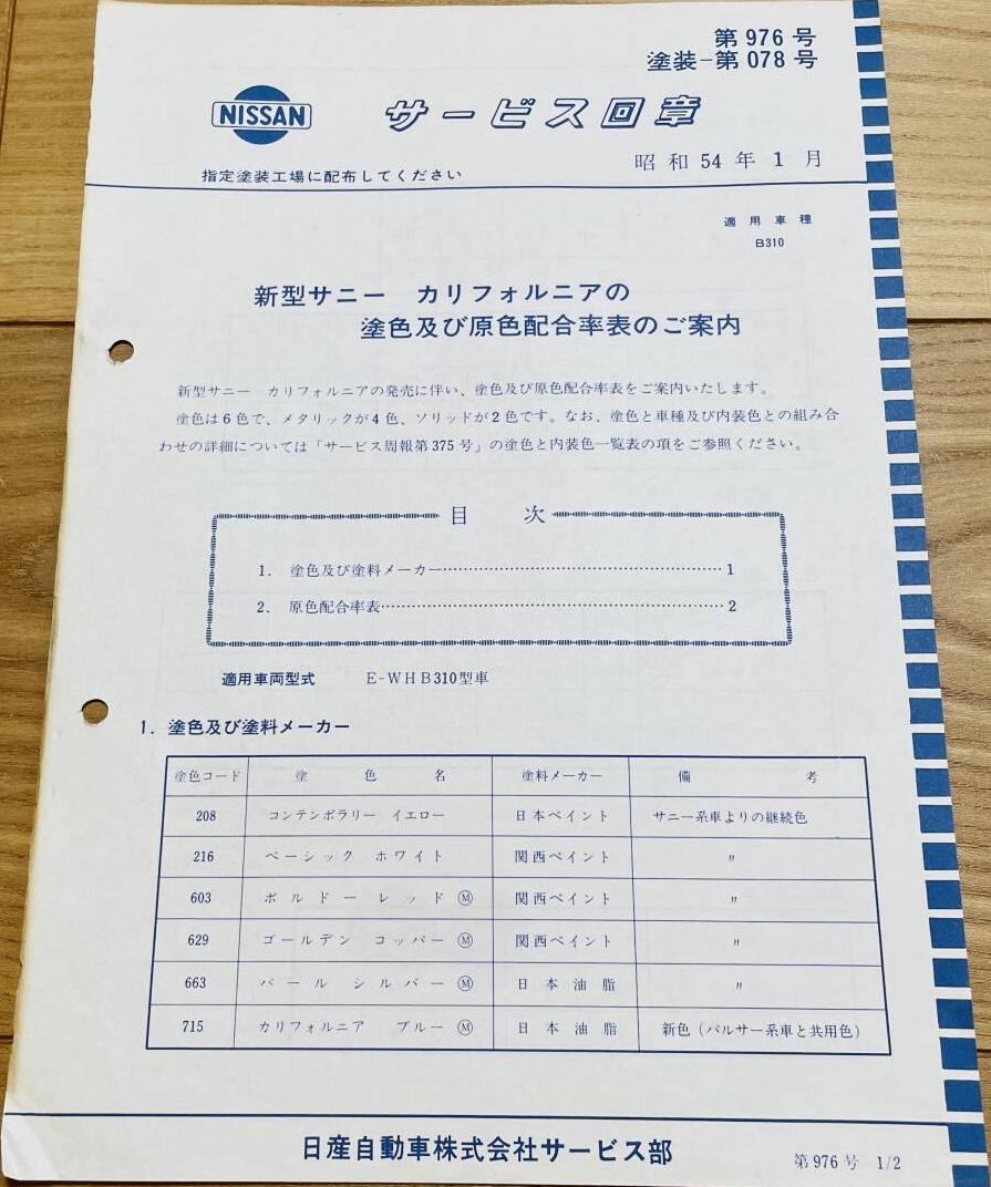

Sunny California Paint Colors
30813.jpgcircular
