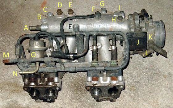

On the bottom of the intake manifold is the water hose. It connects to the front block water tube.
Water hose is "E" in this photo

The PCV bolts to the back end of the plenum, and connects by hose to the normal block breather tube.
Fitting "A" in this photo:

- M: Fuel inlet
- N: Fuel outlet
- O: 22660-N4700 REGULATOR ASSY-PRESSURE [fuel]
- 16443-N4710 HOSE-FUEL (2)
- 16439-N4710 CLAMP-HOSE (4)
