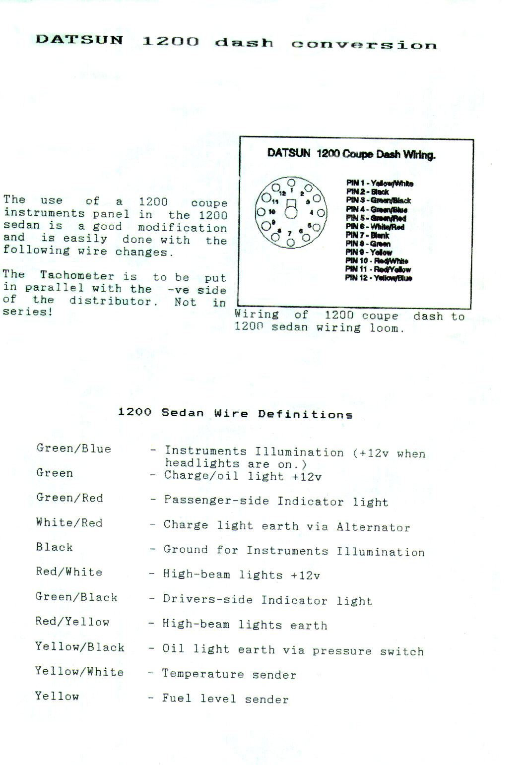

dattodude's original information sheet:
Main Forum discussion: POST Rectangle cluster to round cluster
  • You will need to modify one or two wires
  • Which wires depends on whether your car is a B110 rectangle car, or a B120 rectangle ute
  • Also depends on which dash you are fitting: is it a B110 round cluster or a B120 round cluster?
Dash Change from Round to Rectangle
Conversion from 1979-1987 round dash to circa 1977 bar meter. Instead of rearranging the pins, the plug was cut and all the wires fitted with bullet connectors.
