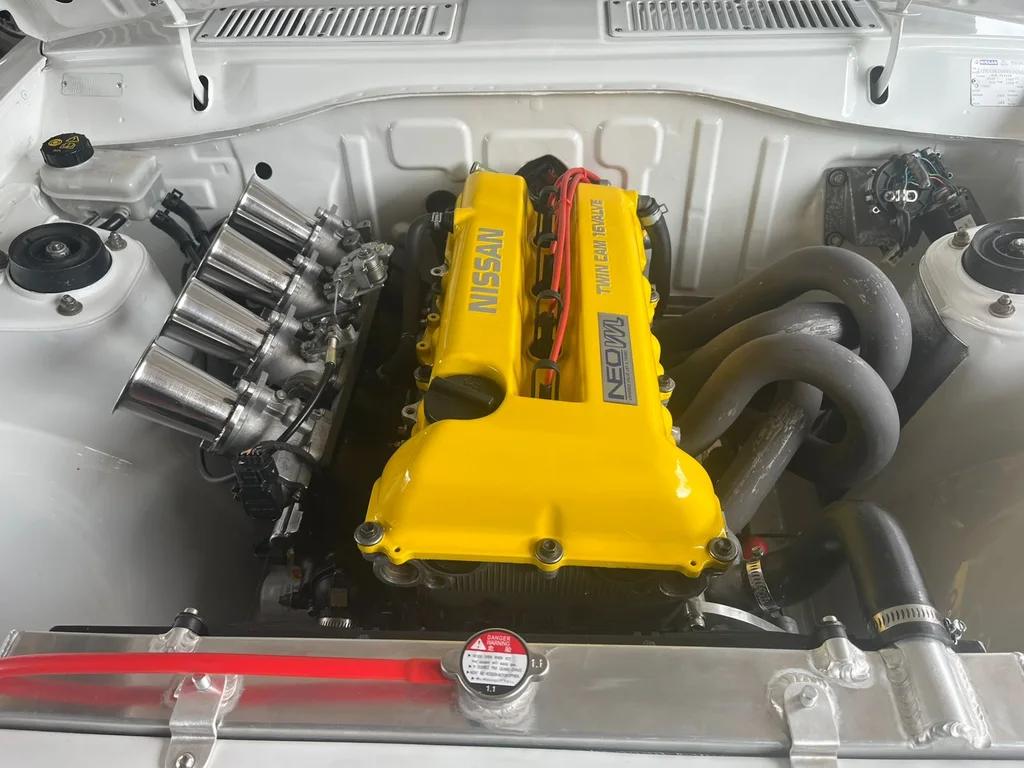

NeoVVL 1200 Coupe
9416.jpgAlbum 9416 9417.jpgAlbum 9417 9418.jpgAlbum 9418
18108.jpgAlbum 18108 18109.jpgAlbum 18109 1121.jpgAlbum 1121

SR20 with Holley 2-BBl carburetor
10298.jpgAlbum 10298
SR20 with GSXR throttle bodies
