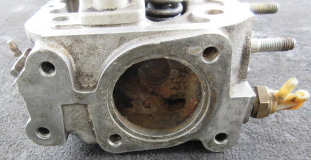

Intake/Exhaust manifold bolt pattern
Early A12 differs from the A14. A12 changed in 1976, but A12 Wagons and Trucks continue to use the old pattern until 1979-1980.
982_.jpgAlbum click to view
Top: New bolt pattern
18992.jpgAlbum 18992
Bottom: Original bolt pattern
The bolt pattern on the cylinder heads also differ. early A10/A12 heads are only drilled for the older pattern. Newer A12 (1980s/1990s) are drilled for newer pattern. Some newer heads are drilled for both.
4440.jpgAlbum 4440
Bolt pattern

Undrilled Boss
A12 with boss, not drilled (late B110)
4587.jpgAlbum 4587
A14 with front boss undrilled
5215.jpgAlbum 5215
Front Boss Drilled & Tapped
With boss (fitted with vacuum switch in this photo)
14137.jpgAlbum 14137
Late A12
1233.jpgAlbum 1233
Front and Rear Bosses
Both bosses drilled and tapped (H72 107 industrial A14)
11415.jpgAlbum click to view
With rear boss not drilled, front boss drilled
2983.jpgAlbum 2983
Blank rear boss, tapped front boss
6290.jpgAlbum 6290
With rear boss drilled, front boss undrilled
5249.jpgAlbum 5249
5250.jpgAlbum 5250
Rear Boss Only
With rear boss (no front boss) H89
1234.jpgAlbum 1234
