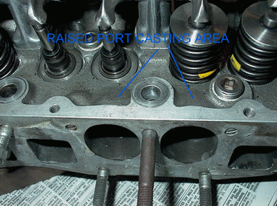

41mm
GX head with 41 mm intake valves & 32 mm exhaust valves
42mm Valves
42 mm intakes are perhaps the limit for A-series cylinder heads.
